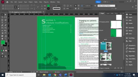

Hi all
this has been an annoying problem i can't seem to fix
1- below is my parent page for a left sided contents list

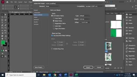

2- when i PDF the book WITH bleeds

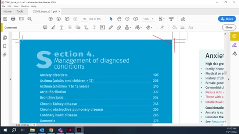

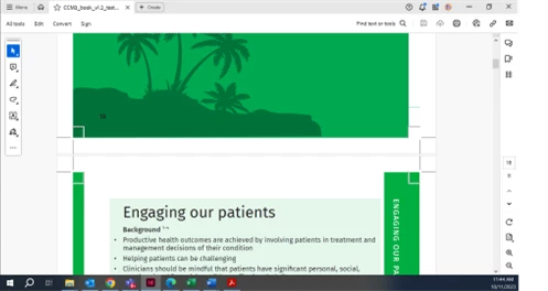

3- the bleed leaks to the next printable page
4- but it only leaks for this page, not the page turners etc
5- help - fire as many questions as you need. ill try and screenshot and answer all questions in a single post
Thanks so much clever people
sean

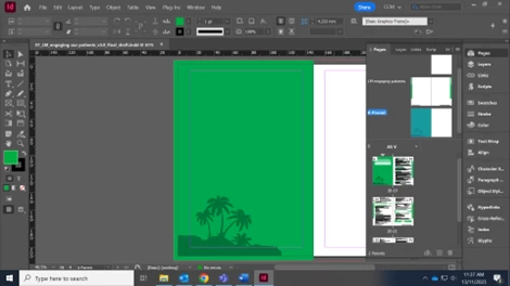

Hi @Sean5CF1 , With facing page documents the Inside Bleed comes from the spread's opposite page. Unless the document's binding method trims and exposes the inside edge (e.g., wire-o), the Inside Bleed gets removed by the printer during imposition. Typically for bindings where the signatures are folded and gathered, the Inside Bleed should be set to 0.

Thanks so much Rob
This is exactly what i was looking for. You are right, the printers will trim the "invasive bleed" away
This will do for me, but it still feels like fudging the bleed to disappear
The bleed should come to the red line on the page with the bleed, not invade the next pages' attributes (as above)
It seems a sloppy work around for such a top notch piece of software. But hey im happy
Thanks again Rob
Sean
rob day
November 14, 2023
What's the binding method? Signatures get folded at the spine, not trimmed. When the pages are imposed into printer spreads there can't be an inside bleed.
