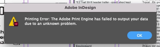

Ever since the latest Adobe update, I have been unable to print a majority of documents from InDesign due to some sort of print engine failure (screenshot attached). I place everything via File Place, and all documents were made with Illustrator. Some files work, others don't, even though they're all made from the exact same template. So now I'm having to export my files ad pdf files and print via Acrobat, which in my line of work is not ideal. This was not an issue until I updated InDesign yesterday (April 26, 2022). I also updated Illustrator and Photoshop, because without the updates, the programs continually crashed and ran sluggighsly. Anyone else having these problems, and is there a solution? Thanks!

Also, I am running Mac OS Monterey 12.3.1 and everything else is also up to date.
