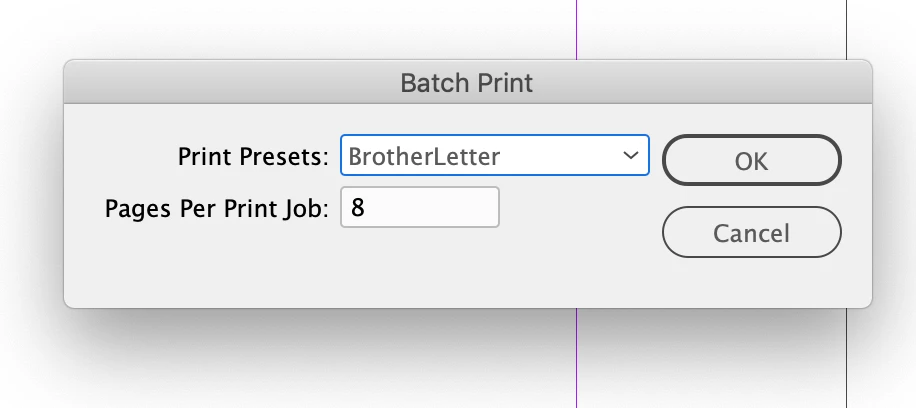

Hi @KR24257751tlmf , just to clarify—page 1 of your 8-page document has the mail merge fields and when you run Create Merged Document... you get a 600 page document that your Ricoh then tries to impose and bind as a 600 page doc?
If that’s the case you could script sending the 75 books to the printer.
rob day
May 12, 2022
Now I have to print each one individually.
Hi @KR24257751tlmf , You are welcome to try this script, it would send the 75 books to the printer as separate print jobs bypassing the Print dialog.
Test it on a small doc first—it will send 75 jobs to your print queue for a 600 pg doc. Dialog lets you pick a print preset, and number of pages per print.
https://shared-assets.adobe.com/link/15ec1477-3835-4e09-5744-3e0a288e3d93
