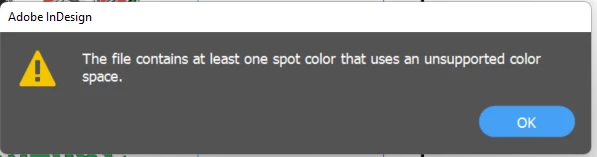

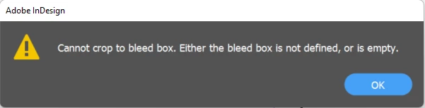

How are you even able to place a PSD with spot channels?
Im getting this "unsupported color space" warning? Its a RGB file with Adobe1998, also tried CMYK with spotv2 and fogra39, nothing works. When i try to save as Photoshop PDF im seeing another warning, issue with missing bleedbo?! Seems totally broken!
Is the only way to go oldskool and separating channels in photoshop?!

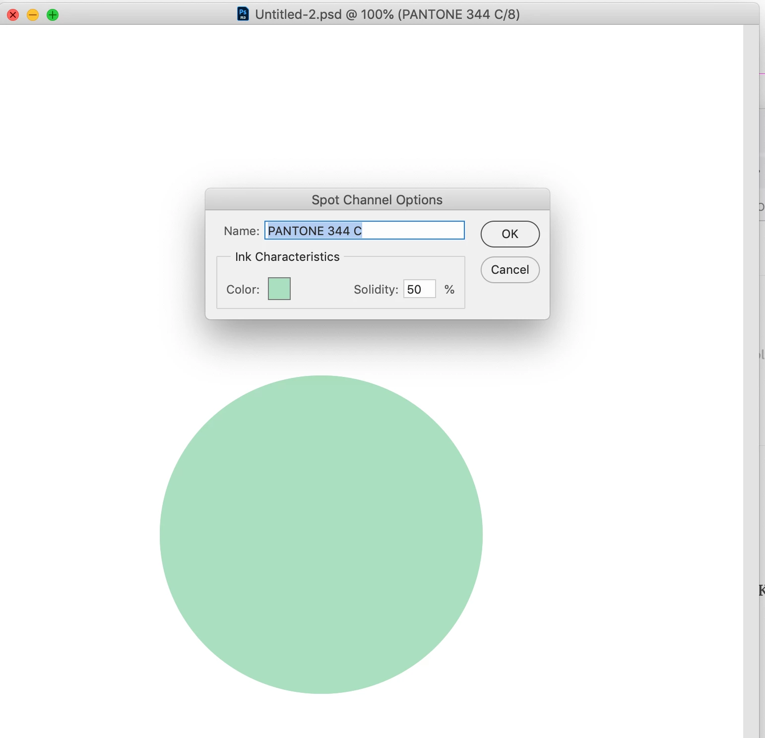

Can you share the .PSD file via DropBox or your CC account? Or, show the file’s Spot Channel Options dialog:
