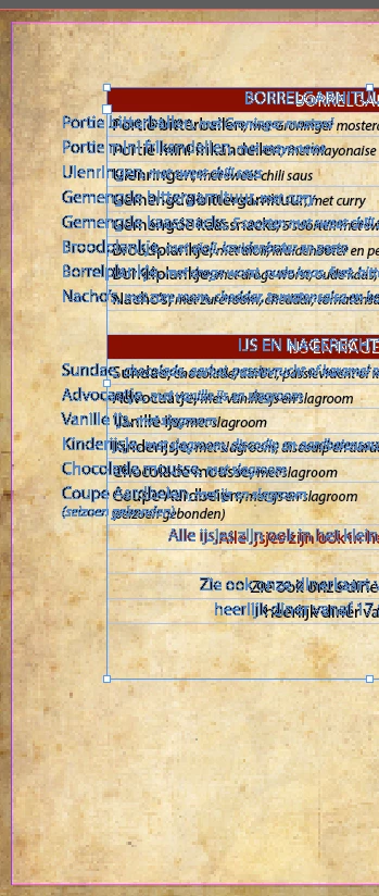

Problem in Indesign with converting text to outlines.
If I convert the text to outlines, a copy remains with the original text. If you view the pdf in acrobat, you will see that the letters are also bolder. If you then edit the file, you will indeed see 2 layers with texts. Is this a bug?

Hi @Wim_Rene ,
thanks for your screenshot.
I suspect that the text frame contains a table object.
In that case InDesign will indeed do a duplicate to convert text to outlines when the text frame is selected.
That behavior is not new.

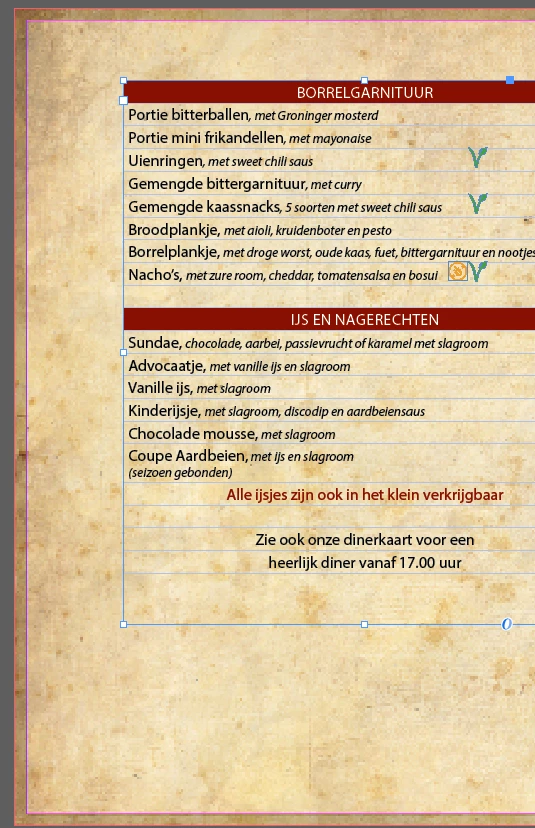

I did some tests.
In my current file there is no copy behind the text box. That only comes when I convert text to outlines.
When I create a new text box and convert it to outlines there is no copy.

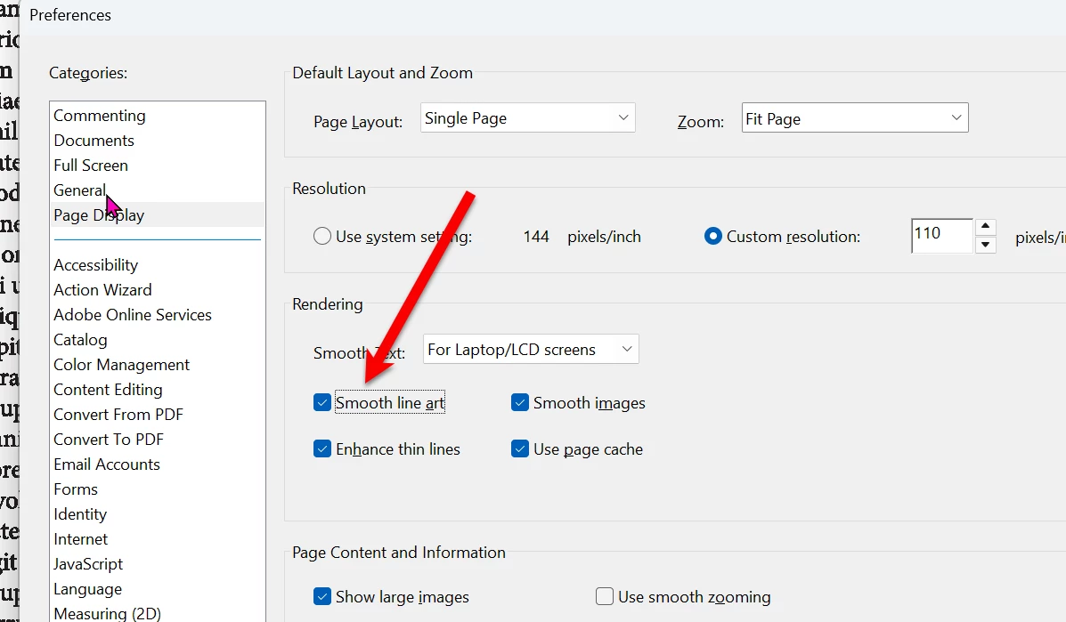

Regarding the bolder text... Make sure your Smooth Line Art preference is on in Acrobat.
Finally, you shouldn't be converting to outlines in InDesign. You will lose certain typographic features. It should be done in Acrobat Pro after you make the PDF. That also leaves your InDesign file intact for future edits. (I won't get into whether you should outline text or not...)

Wim_ReneAuthor
Apr 3, 2025 6:29 AM UTC
Thanks for the reply. I now know what the problem is. I selected the text frame and then a copy is made.
Apr 3, 2025 11:10 AM UTC
@Wim_Rene said: "… I selected the text frame and then a copy is made."
Hm. That should not make a copy of the text.
Just tested that with InDesign 2024 and InDesign 2025.
All as expected: all text of the selected text frame was converted to outlines, no copy of the text frame happened.
HOWEVER:
if you hold the alt (option) key when doing this InDesign does the following:
[1] A duplicate of the text frame will be done
[2] Text in the duplicated text frame will be converted to outlines
