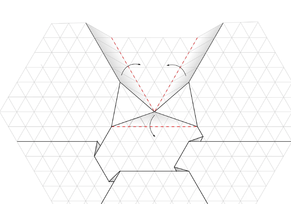

My publisher is composing a book with Indesign using EPS exported from Inkscape. Most of them work fine, but a few with colour gradients appear wrong (on screen and printer).  I have tried to read those EPS files with online tools and they look right. Any idea which could be the problem?.

Thanks for your answer. Yes, Inkscape can export to other formats, but the pusblisher told me EPS was the best to upload the book to Amazon. But after my post, yesterday I got a trial copy of Indesign 2020 and tried the same files (EPS and the original SVG now supported directly), and they look perfect. Maybe it´s a bug of the version the pusblisher is using.

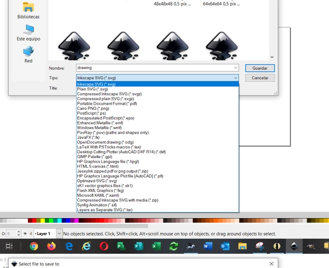

Here are the Inkscape options, anyway:
And I´m including a screen capture of the PDF result of the test I did with INdesign 2020.
