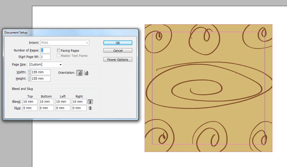

When I export my document, my 10mm bleed becomes this white frame. I have not found a solution on how to get rid of it. I've tried a bunch of different things, and now I'm hoping some nice person here can help me out.
Here is how the bleed looks like in the document:

I want my bleed lines to show, but I don't want that white frame.

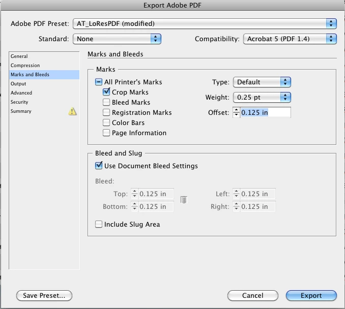

    Did you put an offset  in for the bleeds and crops when you exported the PDF? See attached

    Looking at your last screen grab your crop marks are inside the bleed area. In theory this is OK, since they are supposed to get cut off, but in practice you'll want to add enough offset to move themoutside the bleed area. That's there, after all, just in case the cutter is misaligned, and if it is you don't wan those marks showing up on your finished prints.
    10 mm, by the way  is pretty big for a bleed allowance. 3 mm is pretty normal.

    Toggle "Use Document Bleed Setting" from the Export > Marks and Bleeds
    You have defined the bleed in the setup, but did not envoke it.

    However, when I set "use documents bleed settings" in export>Marks and Bleeds, I still get the white frame. The pdf looks exactly the same.

    I found the solution!
    In export under Marks and Bleeds I had to activate "crop marks", and deactivate "bleed marks". While having the Use document bleed setting on. Now the white frame is gone!
