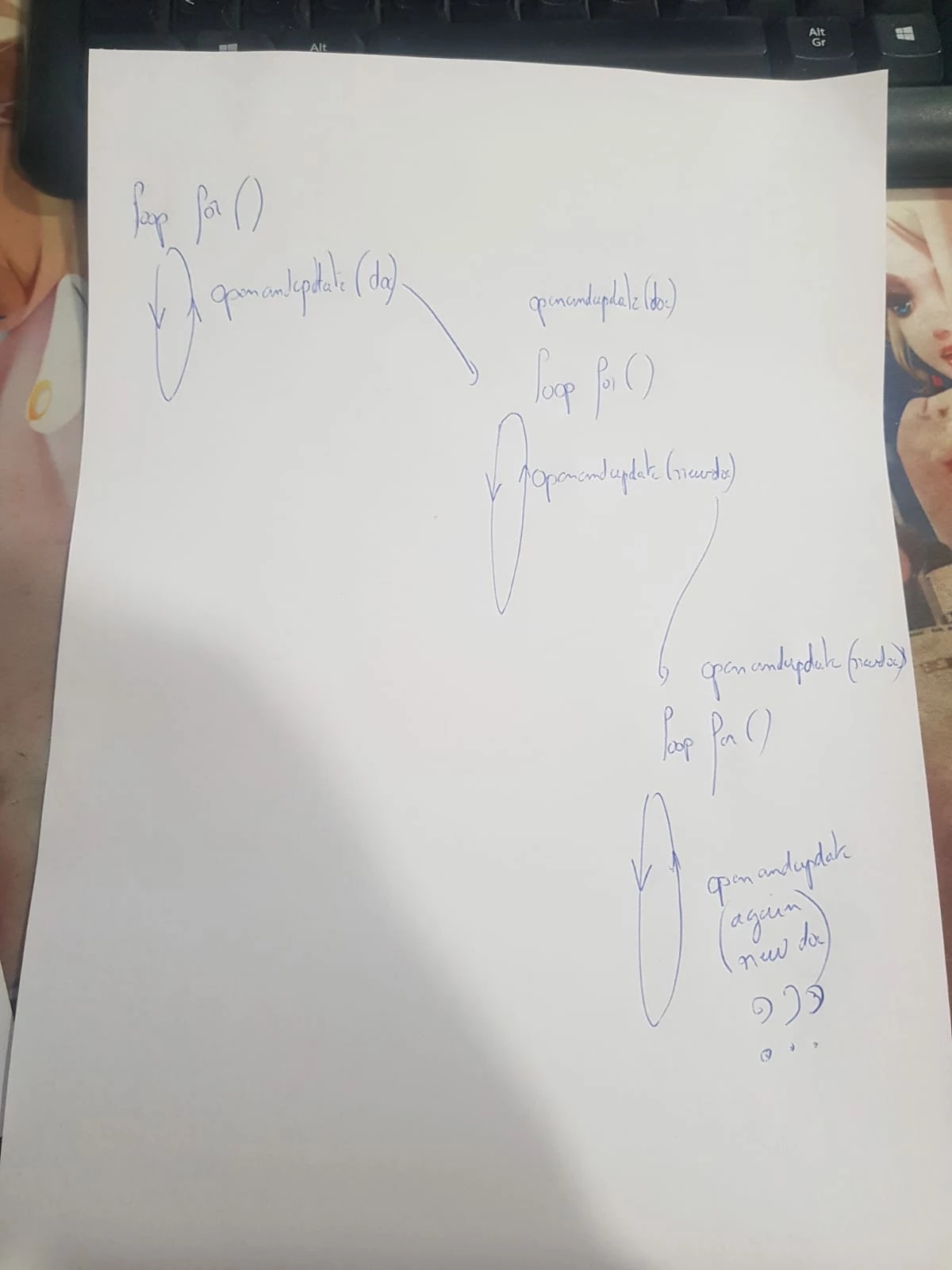

November 9, 2022
about () in the name, it s only into the test file, i have not verify after copy past
about the problem i have maybe find, if you have test, that mean you have check the script, and thanks
i will draw a picture and tell me if i m right or wrong
about nested file, it s my architecture, all my file are nested, for automatisation, and commun file or common style
look picture attached
