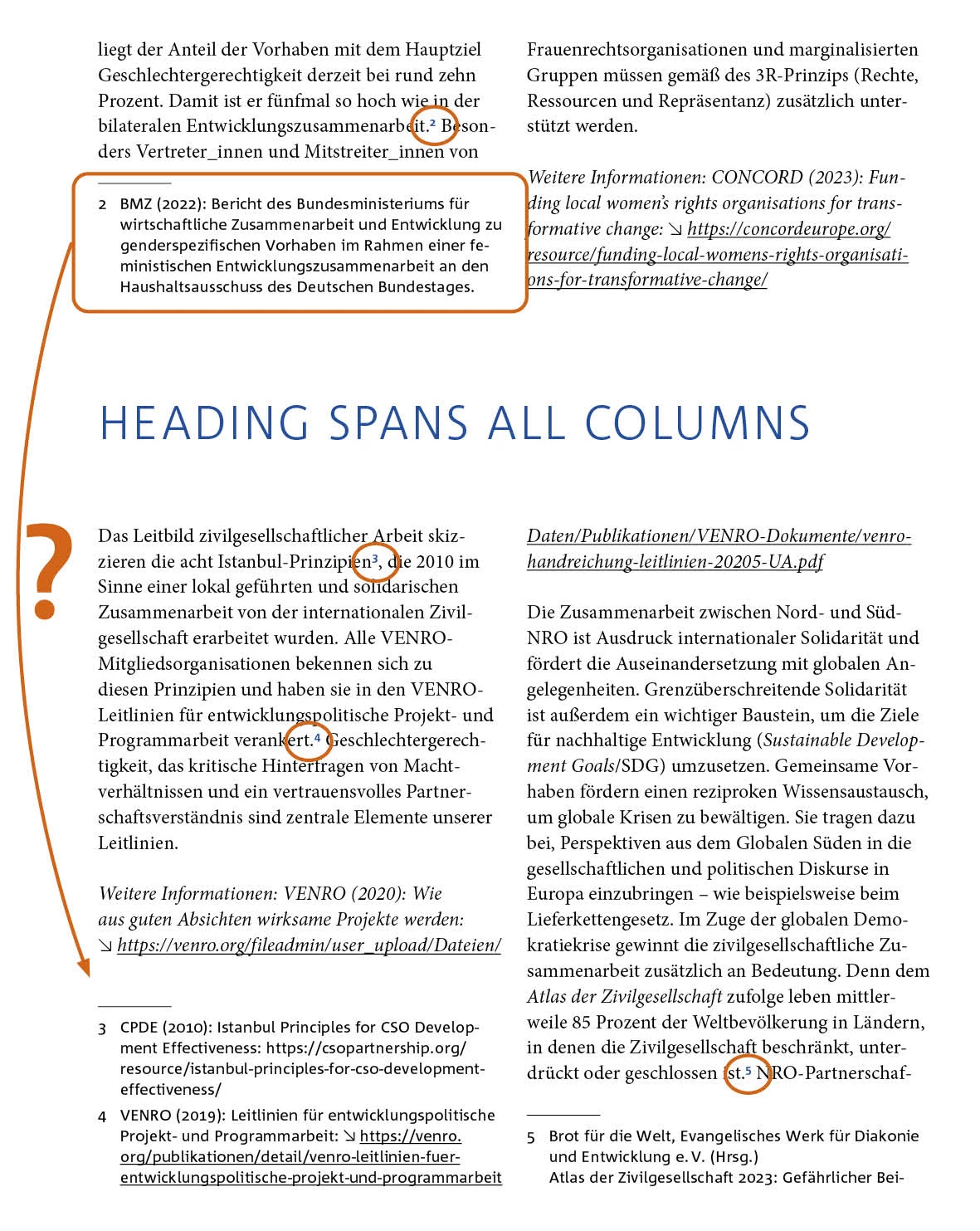

Hi there, I created a 2 column layout. The heading is set to span all columns. The text contains some footnotes before the heading and some after it.

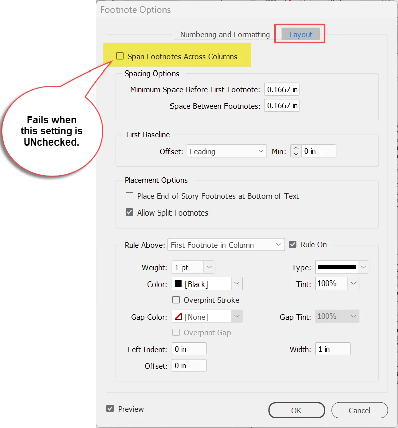

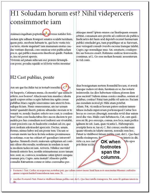

The problem is that some of the footnotes appear above the heading instead of at the bottom of the page (see jpg). Is this on purpose or is it a bug? When I allow footnotes also to span columns, they gather nicely all together at the bottom of the page.
But I need them all to sit at the bottom without spanning columns. Is there any way to solve the problem?

Correct answer Bevi Chagnon - PubCom.com
quote
Hi Frans, did you happen to officially log this in the prerelease bug base?
--Bevi
No, because I think it is 'by design' or a 'design limitation' and not a bug to be honest...
I agree, it's lousy design.
But the engineering team still needs a formal bug to have it considered and authorized by the Adobe "powers". The engineners do not control what they work on.
If needed, you can grab any of my screen captures to augment yours in the bug report.
And post the bug numeber in the main prerelease discussion so we can chime in and confirm the problem.

It is ugly, as this seems to be 'by design' indeed with no work around except the 'old' way of a separate threaded text frame.
I guss not a bug but a poor programming choice...

Yes, it's one single textframe. It really seems like InDesign treats span columns elements as a section break.
But in this case it makes no sense at all setting footnotes above a heading on the middle of a page.
