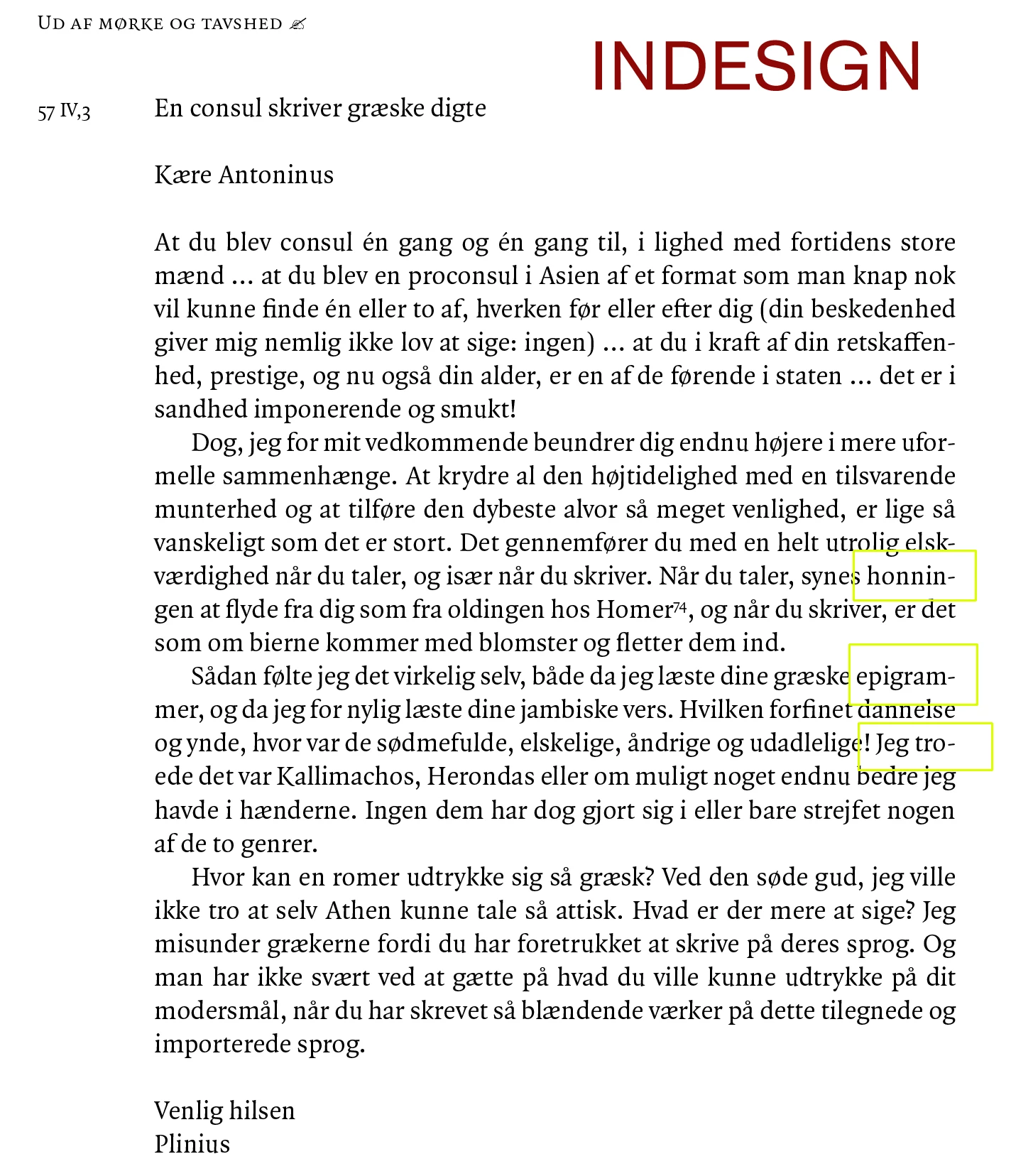

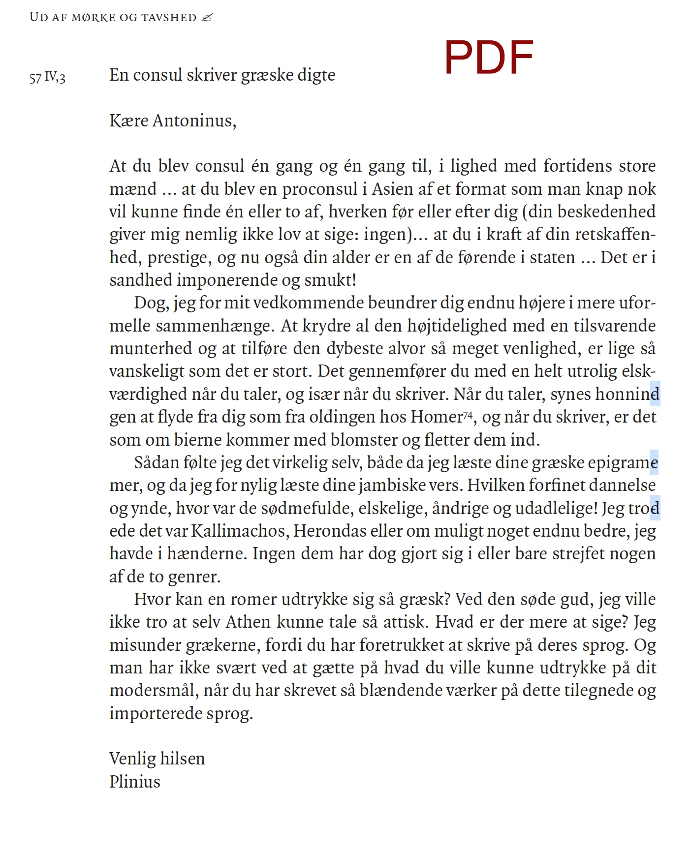

I have now in several different documents had the same
problem that some words, at the end of a sentence and
with a hyphen, in the exported pdf, appear with a strange sign.
I don't see this sign in indesign, but in the pdf it's clear. What is this cause?

Hi together,
I think, that's a known bug!
Did you enable the option "PDF Tags" in the export preset for PDF?
Try to disable it and export again.
If this is not possible because you need a tagged PDF we have to go to the source of the issue. And unfortunately this is the usage of the "Adobe World-Ready Composer" plus perhaps some formatting overrides with your paragraphs. Change text composition to the "Adobe Paragraph Composer" or the "Adobe Single-line Composer" to get rid of the issue. However that means, that you have to proofread the whole document again.

My two cents. I had the similar problem. In my case I found out that I had 2 different languages set inside one paragraph. After changing whole paragraph to one language, everything works fine. As soon as I set one word to be from different language, similar problem with hyphen over character is back.
