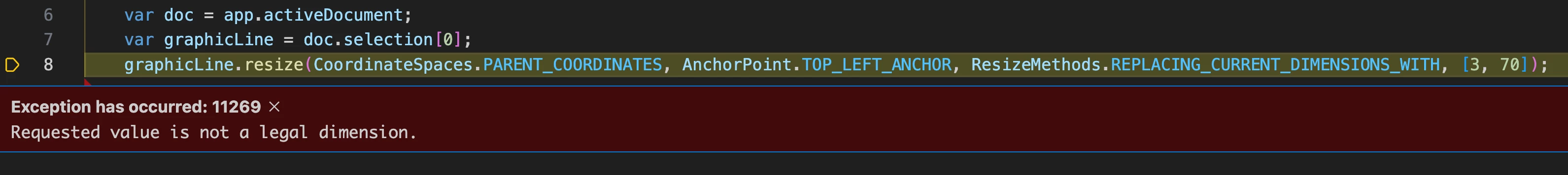

Can someone confirm that in InDesign 19.5.1 this snippet errors when applied on a vertical graphic line:
resize someLine in outer stroke bounds from top left anchor by replacing current dimensions with values {3, 70}
 The same goes with a horizontal graphic line with inverted values {70, 3}
[error 11269 : the requested value is not an allowed dimension]

Hi @zeRafio, I can confirm this error in ExtendScript:
I mean... it makes sense, right? A vertical line has no width—it has zero width, and moreover it can't have width. So the error makes perfect sense.
You can see this happening here:
graphicLine.resize(
    CoordinateSpaces.PARENT_COORDINATES,
    AnchorPoint.TOP_LEFT_ANCHOR,
    ResizeMethods.MULTIPLYING_CURRENT_DIMENSIONS_BY,
    [1, 4]
This operation works fine, without error, on a vertical line, because it isn't trying to change the width. But this will throw the error:
graphicLine.resize(
    [1.1, 4]
 Are you trying to achieve something? Are you trying to avoid this error? Or just curious? Maybe you should work with a Rectangle rather than a GraphicLine?
