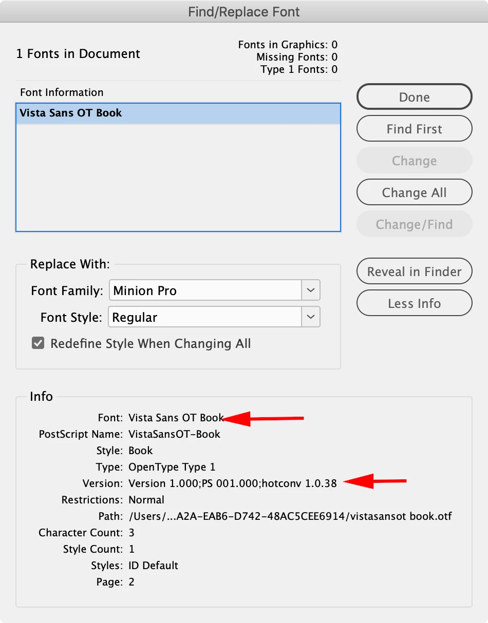

Also are you sure the same versions of the fonts are installed on both machines? See Type>Find/Replace Font>More Info to get the version numbers.

Very good point. Mapping to "equivalent" fonts would almost certainly mess up overall text spacing, and if one system dates from >10 years back it's almost certainly got a different font set than the newer one.
