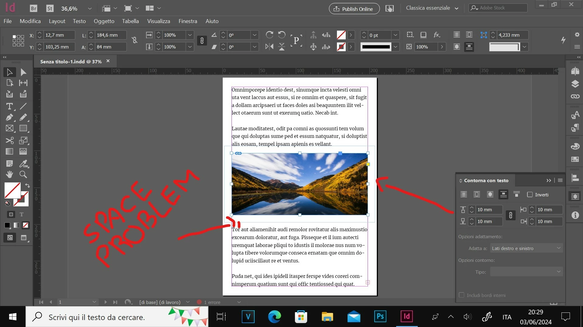

Hello there. I've got a problem with the Text Wrap option. You can see an example in the screen. I have an image with this option (text up and down) and I set some margins. Problem is, I can't have the same space between the texts and the image. The text above the image is perfectly attached to the margin, but the text below the image is not. How can I solve? Thanks.
Correct answer Brad @ Roaring Mouse
"but InDesign keeps keeping a space between the lower text and the margin..."

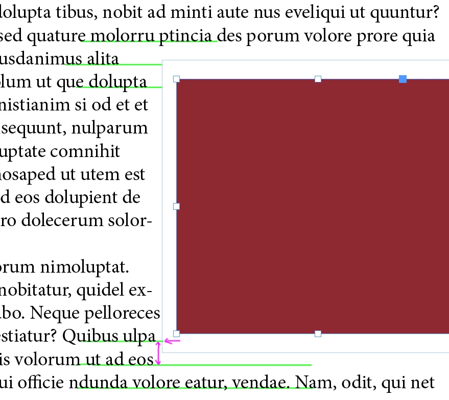

This is going to sound weird but this is actually normal behaviour. Text line spacing is based on the leading of the line, and this affects your wraps. The difference for the top line (only) in your text frame is that it uses a different calculation based on your Baseline Option for the text frame (which is likely Ascent, which crops off the leading up to the top of the type).
If you changed your Baseline Option to leading, you'd see exactly the same effect. As far as I know ID has yet to implement the ability to do the same calculation to text below a wrap.
Your option then is to reduce your bottom wrap dimension as mentioned by others on the thread.

@Peter Kahrel sorry I forgot to attach the image, I've just done it. Reguarding the option, I disabled it and the text moved further up towards the margin, but it didn't stick to the margin like the upper text...
It's strange. I can move the image everywhere and make the upper text stick perfectly to the margin, but InDesign keeps keeping a space between the lower text and the margin...

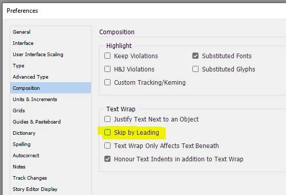

You didn't include your screenshot. However, it sounds very much like you want to disable 'skip by leading' in the Preferences:
If that doesn't fix the problem, please do show your screenshot.
