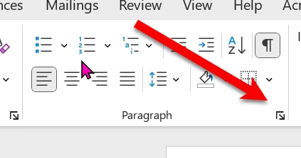

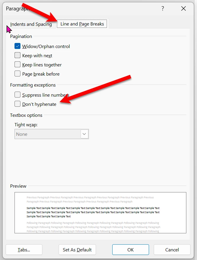

If you are referring to auto-hyphenaton, it's on by default in Word.
Whether it is auto-hyphenated in Word or not, shouldn't affect your InDesign settings.
To see the settings in Word:

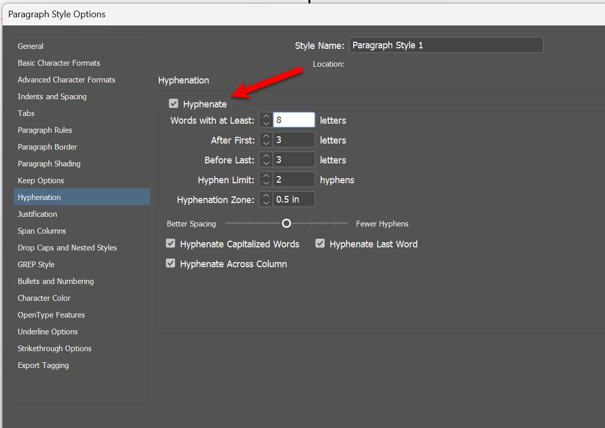

In InDesign--using paragraph styles, which I strongly recommend:
(Be sure to adjust your settings to your requirements.)

But yes, if the OP means auto-hyphenation, that's something you want to strip/remove from Word and allow InDesign to handle with its native capability.
