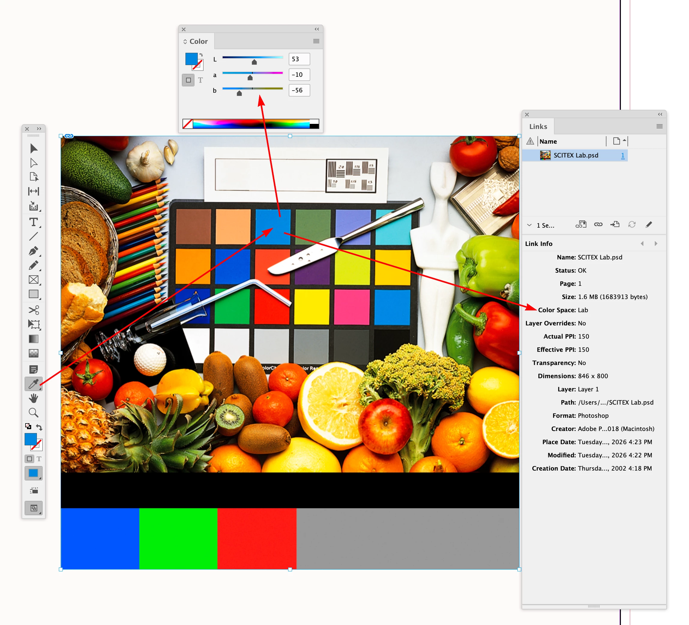

    rob day
    Aug 25, 2026 8:28 PM UTC
    For me this is a novelty since the InDesign update
    Hi ​@Elsa+Bordes , Sampling color from placed Illustrator and PDF container files has allays been a color managed conversion to document RGB—I have copies of InDesign back to CS6 and can confirm the behavior in all versions.
    AI and PDF can contain a mix of color spaces and color profiles, while an image always has a single color space and profile. So if I sample a CMYK image, I get a CMYK color, sample Lab or RGB images, I get Lab or RGB colors.
