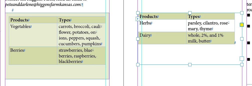

Bonjour,
j'ai mis en forme ma table des matières, mais elle est trop longue pour tenir sur 1 seule page. Réduire la police la rendrait illisible. Y-a-t-il une solution pour étendre la table de matières sur 2 pages ?
D'avance merci.

Here's an example where I did that:
Steve Werner
July 20, 2023
It's easy to continue a table on a second page. Tables are always contained within text frames. To continue the text flow, as you would normally do with text frames, click the outport at the bottom right of the text frame, and use the text placement cursor to draw out a second frame. The table will continue in the second frame.
July 20, 2023
Hello, i thank you very much ! It's really easy... but not for me🤢 until you show me 😊 !!
Now it's OK. Thanks again, have a nice day,
