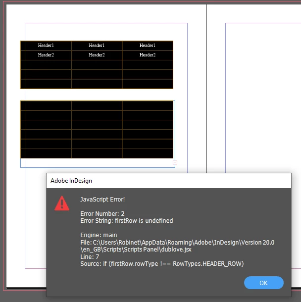

Problems encountered: Use a script to get the current mouse-selected rows and repeat them.
Hello, everyone. Hello @Peter Kahrel.
I Use a script to get the current mouse-selected rows and repeat them.
I  Saw a posting above on "creativepro.com" , at the bottom of the page, where Peter Kahrel gave a solution at the end.
I mimicked one and for some reason it prompted an error.
https://creativepro.com/topic/get-selected-table-rows-with-extendscript/
Help me look at it.
Thank you very much.
Below is the code I cobbled together.  There's also an attachment.
var cell = app.selection[0].parent.parentRow.cells[0];
var myTable = cell.parent.parent;
var selectedRows = myTable.rows.itemByRange(cell,myTable.cells[-1]).select();
//var myTable = cell.parent
//firstRow = myTable.rows[0];
if (firstRow.rowType !== RowTypes.HEADER_ROW)
	dupeTopRow(myTable);
	myTable.rows.add(LocationOptions.BEFORE, selectedRows);
* duplicate the first row af a myTable
* @ param the myTable
* @ return void
function dupeTopRow(t){
    var newRow = t.rows.add(LocationOptions.BEFORE, t.selectedRows);
    var newCell = newRow.cells
    var lr = t.rows[1].cells
    for (var i = 0; i < newCell.length; i++){
        newCell[i].properties = lr[i].properties;
else{
alert("header exist")
exit ();
11 replies
dublove
dubloveAuthor
Dec 27, 2024 6:20 AM UTC
I used a dumb way to duplicate rows 1 and 2.
Couldn't this be done with just one function?
It would be easier if you could make a judgment based on the rows selected by the mouse.
Please guide me.
//dub header
var cell = app.activeDocument.selection[0].parent
//duplicat row1
* @ return void
    var newRow = t.rows.add(LocationOptions.BEFORE, t.rows[0]);//past here
    var lr = t.rows[1].cells//copy which row
//dublicat row2
dupeTopRow2(myTable);
function dupeTopRow2(b){
    var newRow2 = b.rows.add(LocationOptions.BEFORE, b.rows[1]);//past here
    var newCell2 = newRow2.cells
    var nr = b.rows[3].cells//copy which row
    for (var j = 0; j < newCell2.length; j++){
		newCell2[j].properties = nr[j].properties;
else{
exit ();

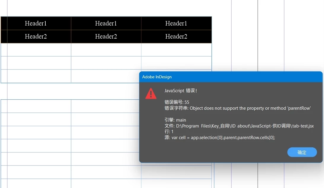

Robert at ID-Tasker
Dec 26, 2024 8:40 PM UTC
OK, I've checked the original code - you haven't read first line of Peter's reply:
"This works: select an an insertion point in any cell, then do this:"
But your selection is bunch of Cells.
dublove
dubloveAuthor
Dec 27, 2024 2:36 AM UTC
I read it wrong.
I thought that this would get the currently selected rows.
Robert at ID-Tasker
Dec 26, 2024 8:36 PM UTC
Too many parents:
First "parent" - gets you the Table - so you need to drop it, because Table doesn't have "parentRow":
var cell = app.selection[0].parentRow.cells[0];
But then - you still have a problem:
And if you want to ping Peter - you need to make a space before "@".
