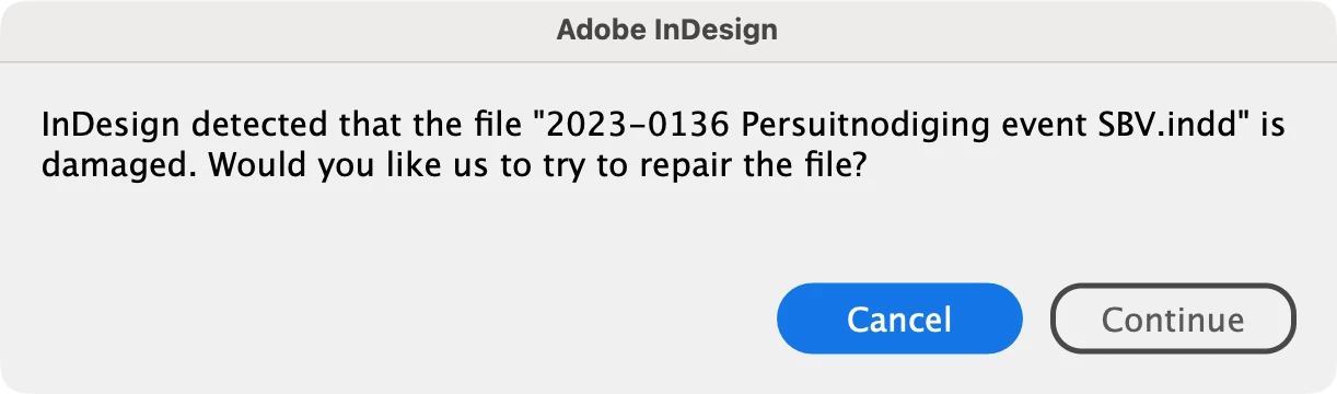

Problems opening files created in InDesign 2023 - InDesign detected that the file is damaged
I’m having trouble opening older InDesign-files. Files from 2023 won’t open anymore in InDesign2026.
I get an error like on the screenshot. But it will never repair the files.
The older files do open in Indesign2024 …

    Hello @yvan at work
    I’m sorry to hear about your experience. I was able to open the shared file in InDesign 21.3 without any issues. Could you check if there are any pending OS/InDesign updates and install them to see if it helps?
    Also, try opening the file in InDesign after moving it to a local folder on your computer that is not being synced/backed up, and share your observations.
    Looking forward to hearing from you.
    Anubhav

    In addition to other suggestions:
    Try to export to IDML from InDesign 2024, then open in 2026. Will it work?

    Opening in 2024 works, resave as indd under another name works, opening that resaved file in 2026 works as well.

    So 2023 files open fine on 2024 but 2026 gives this error and then never repairs or opens the file? Does this happen with all files or just some particular file? What is the OS?
    -Manan

    I checked some other files and they open normally. It occurred to me 2 times this week that there is a file that won’t open. Different clients/files, not related to each other.
    macOS Tahoe 23.3.1
    I will attach my file here ...

    Tahoe has been seem to be having problems with InDesign. If possible try it on a version prior to Tahoe. The file opened fine for me on 2026 on MacOS Sequoia 15.7.4
    -Manan
