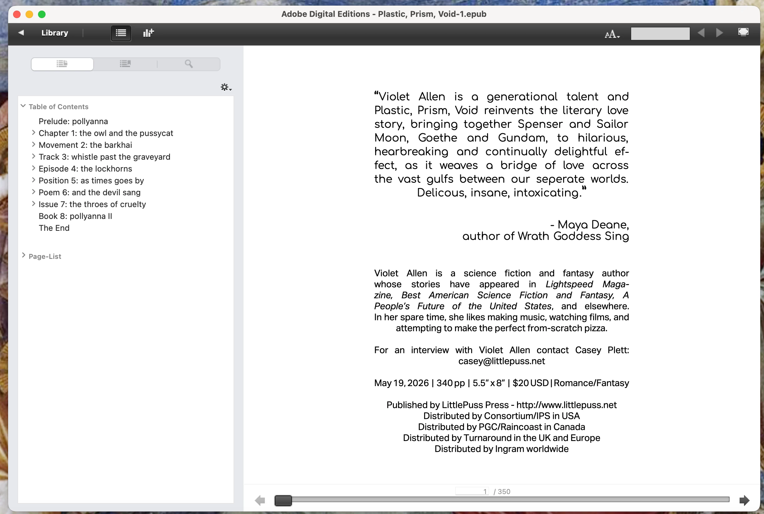

Abhishek! HI! Thanks! Yes!
I'm currently on cc and my indesign version is 20.5.
It's kind of hard to show the problem in screenshots becasue the problem is what's not there, but here goes:
So like,  you open the ebook, the first page displays,

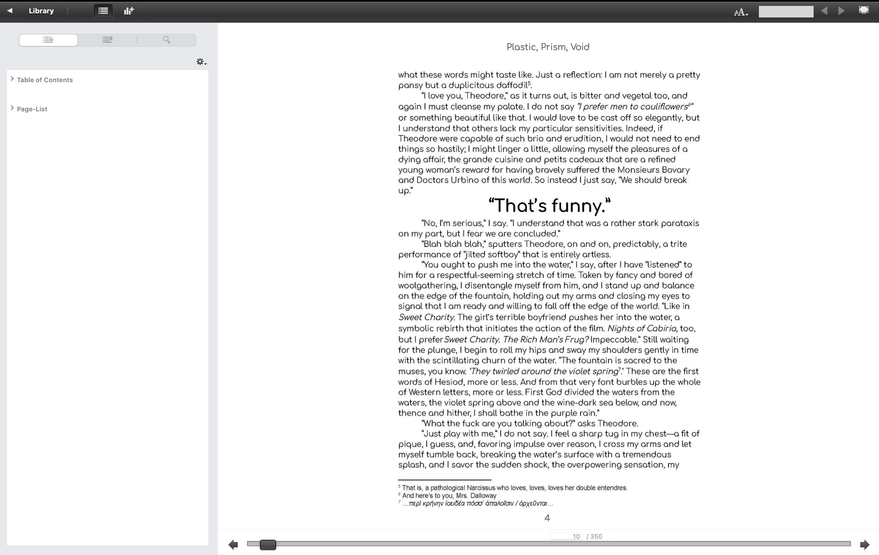

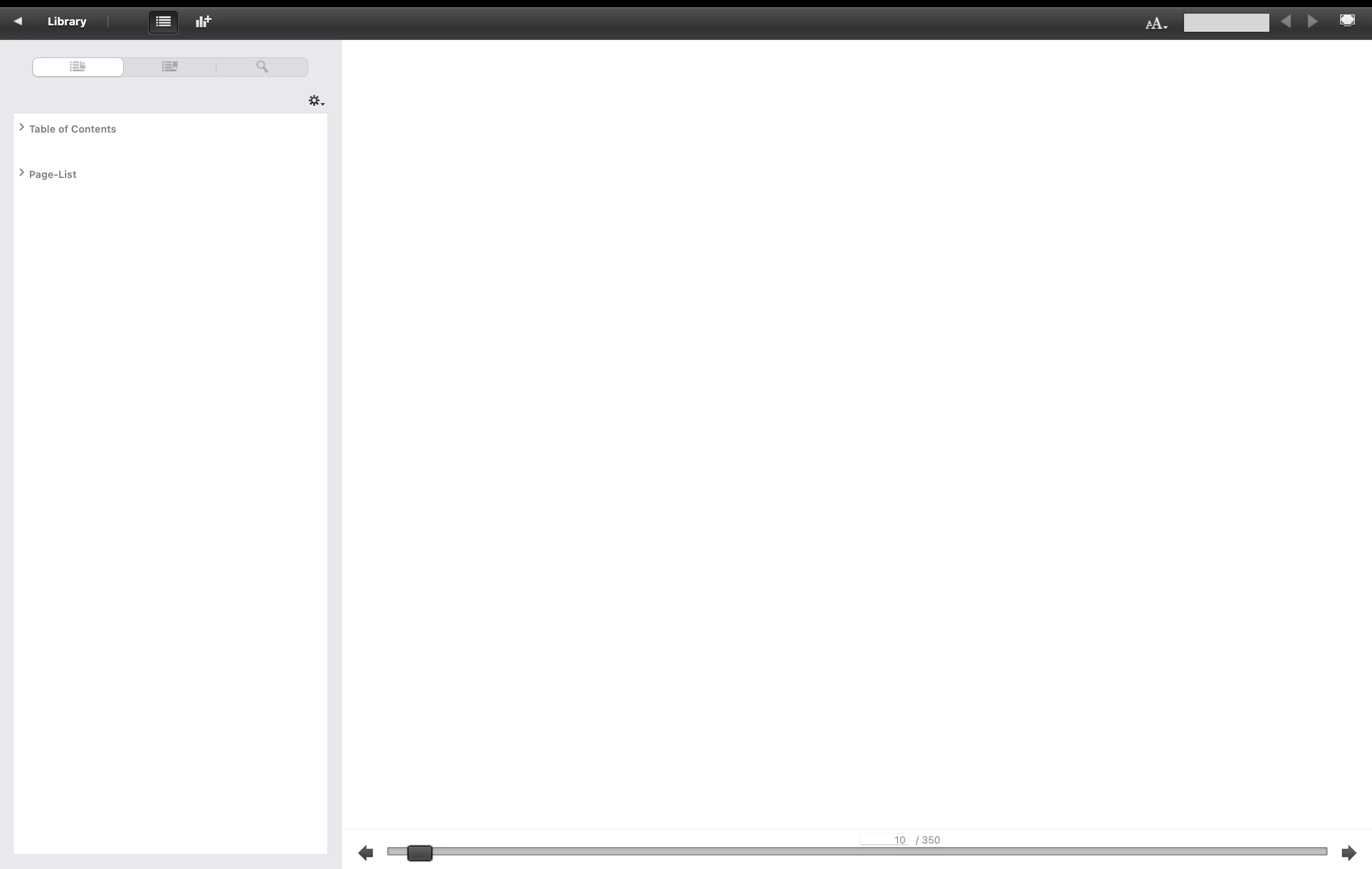

but if you click through to subsequent pages it is mostly just blank (occasionally a single page will load, but 95% don't)
But then if you click a few times on the blank space (it doesn't seem to be a consistent number of times, sometimes three, sometimes four, sometimes more) the page appears! If you do not click it never appears!
Once it appears it looks normal though
Sometines it gets stuck and won't let you chnage the page also! It is very strange behaviour and any hep appreciated
