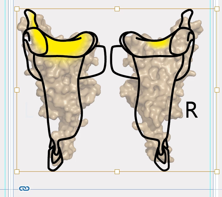

I am working on a table figure in InDesign, and around a mounth ago I started having an issue with placing illustrator files into the table. For some reason, some of the elements in the illustration disapear once I place them into indesign.
File in illustrator:
Placed in InDesign:
When I export the file (I have 6 of those illustrations) the R, L or both just disapear. I tried changing the font or making them into vectors so it won't be a font problem, but nothing works. The only solution was placing PNG file instead, but it lowers the quality, so it is not desirable.

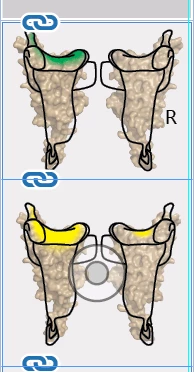

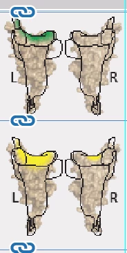

Unfortunally I can't because it is a figure for a jurnal article, so it is "secret" untill published. Some of the R/L letters just disapear. Iam honestly at my wits end with this. I tried to chet with adobe agent but I can't catch them on working hours.
here is the problamatic part on typical display: (seems to be working)
high quality display: (not working)
exporting doesn't work either.

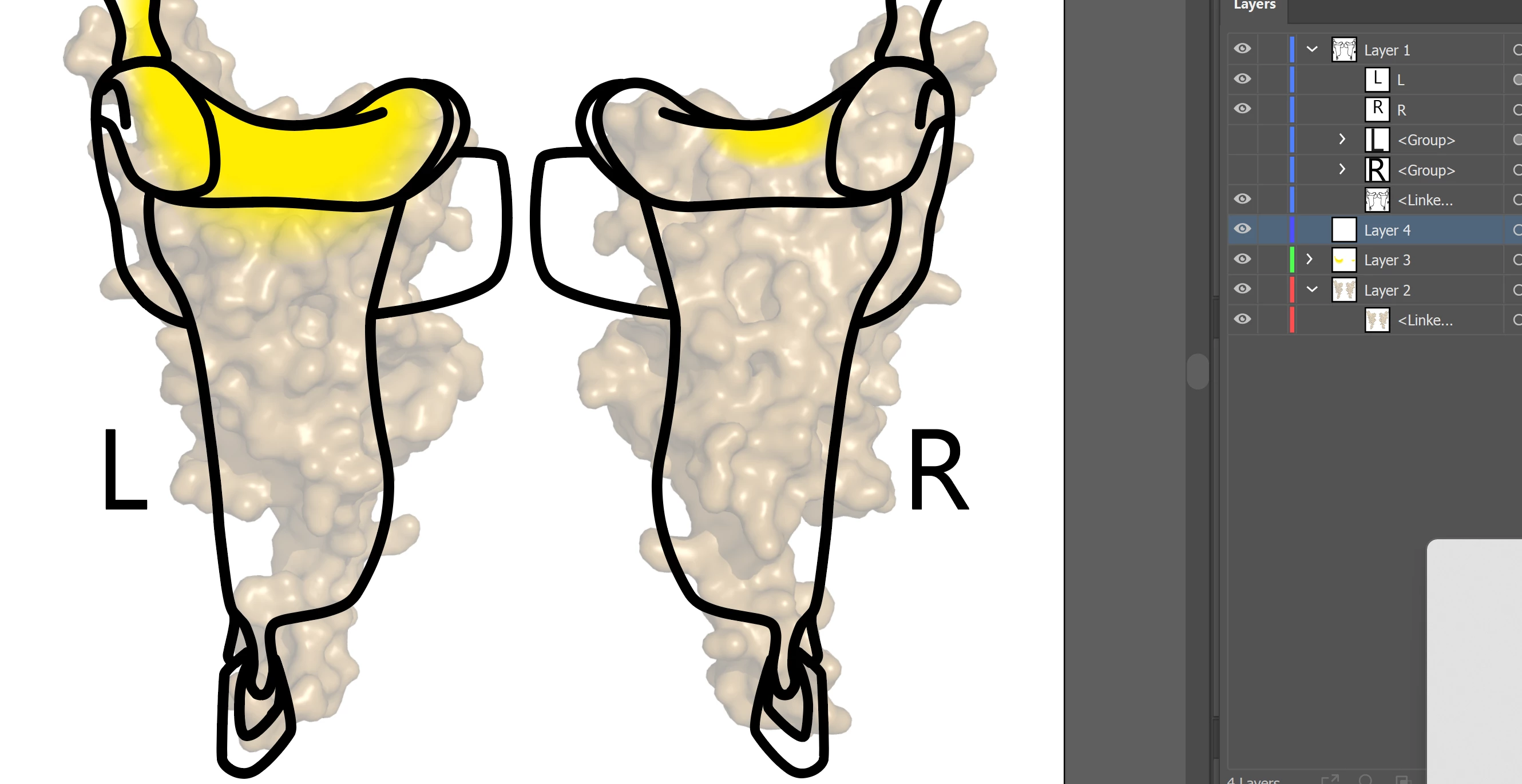

BobLevine
Feb 12, 2023 4:03 PM UTC
Again, sounds like an Illustrator issue. Are those letters on a layer? If not, create a new, top layer and move them there. Make sure there are no effects assigned to them and try again being sure to save with the default PDF settings.

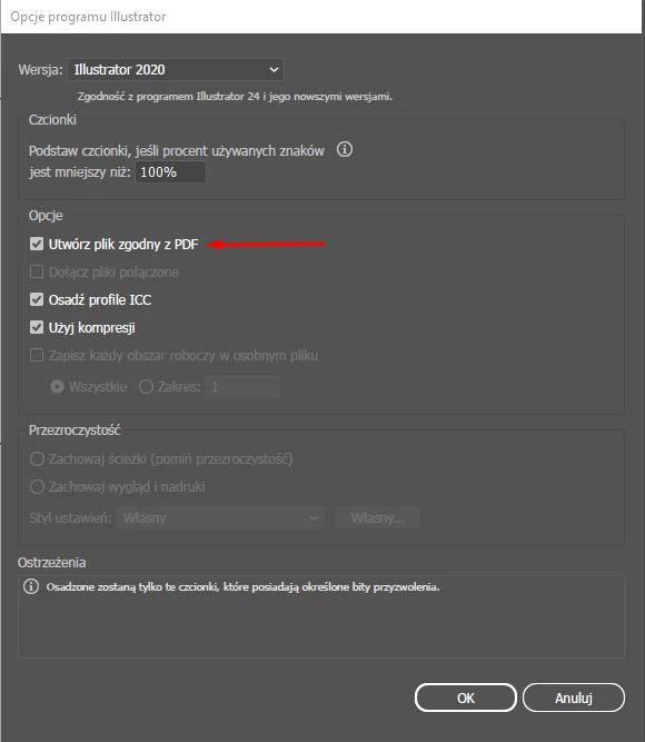

Feb 12, 2023 10:11 AM UTC
One more thing – check if AI file is compatybile with PDF. When You save AI file an options windows appeare and in otpions section. I haxe polish AI but this checkbox should be in the same position
BobLevine
Feb 12, 2023 12:18 PM UTC
Absolutely NOT the issue here. If you don't save with PDF compatibility nothing would be displayed except and alert that there's no PDF data.
