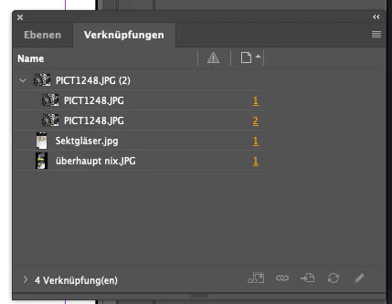

I would like to access the links in the link list in my C++ plugin.
I need the path to the linked file and the page number.
I came up with some code that works, but it seems a bit cumbersome to me and i am not sure if this is the right approach.

Is there an easier way to do this and are there any pitfalls I need to be aware of?
Thanks
