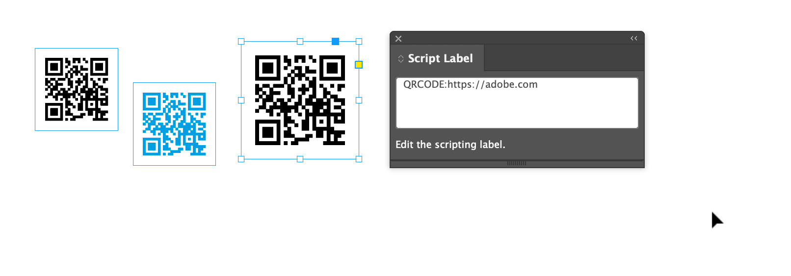

Feb 12, 2025 6:47 AM UTC
Hi @kj_28, editing the contents of QR Codes is surprisingly complicated—as Robert mentioned. However, if you are able to do a bit of work up front to label each QR Code with the contents, then it becomes a lot easier. I'm not sure if you can do that in your case, but I think it should be possible for many jobs.
To use the script, you must first give each QR Code a "Script Label" that looks like this:
QRCODE:https://adobe.com
QR Codes without this labelling will be ignored. Script Label can be set in the "Script Label" panel (Window > Utility > Script Label).
Here is a quick demo running on my computer. You only select one QR Code, and it will change all of them if they have the same label.
To set the swatch color of a QR Code (like the second one above) you must set the stroke color of its frame (and give it 0% tint if you don't want to see it). This might seem a bit strange, but I didn't want to make the script too complicated and this was a way to update multiple QRCodes which can be in arbitrary colors.
Look at my attached demo.indd if you're not sure how I set it up—although it's very simple. If you end up using it, let me know!
- Mark

Robert at ID-Tasker
Feb 12, 2025 11:44 AM UTC
But if user will have to set the label manually for each QR code - he can edit QR code straight away?
I'm pretty sure @kj_28 wants to edit QR codes in bulk - from a list / database.
Or just change one word to another - like "http://" to "https://" or change name of the domain, etc.
m1b
Feb 12, 2025 1:39 PM UTC
Hi Robert, I am thinking of a case where you set up a document with multiple (same URL) QR Codes. Not data merge or anything. Then running script with any one selected will update all of them. I don't know if that is what OP wants—as Eugene mentioned, we don't have a lot of information yet— but I can see that being handy in some real situations.
- Mark
