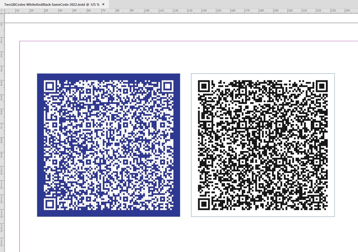

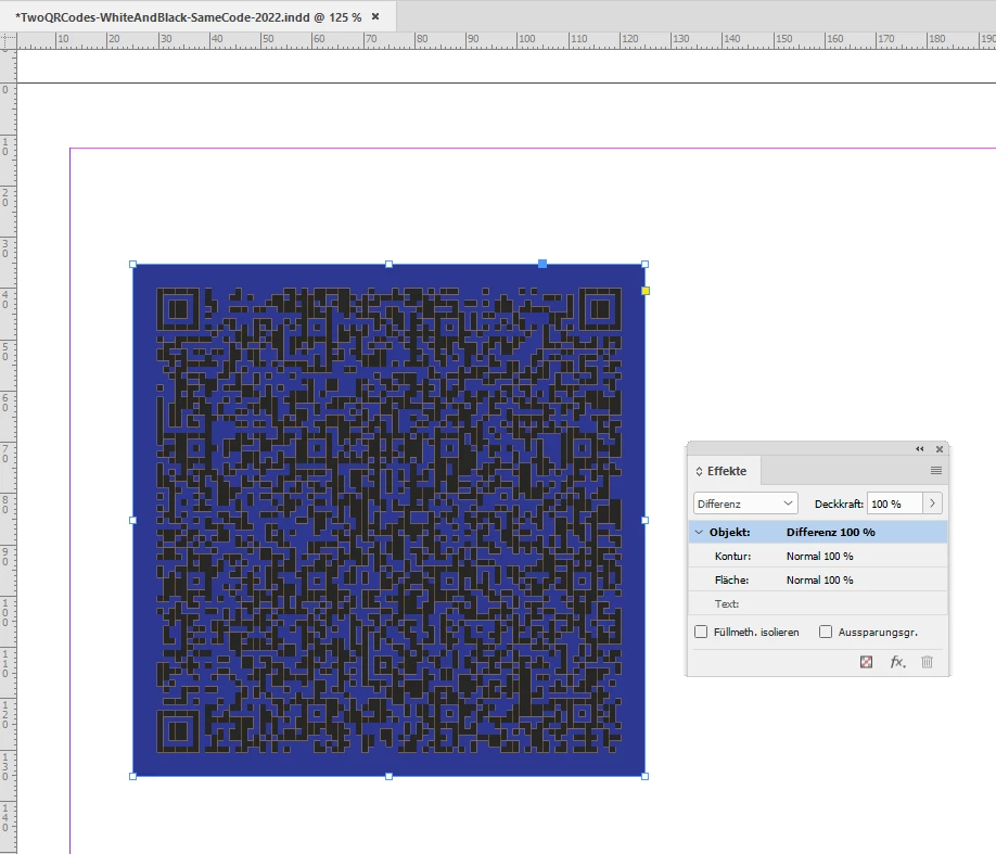

Hi Rémi,
just used your Vcard V3.0 sample text to create a QR-Code in [Paper] and another one with [Black].
I see no differences in the rendering of both codes with my German InDesign 2022 version 17.1.0.50.
Checked this with stacking both frames on top of each other and used the Effects panel to apply the "Difference" effect to the top one. Here some screenshots:
Download the document from my Dropbox:
https://www.dropbox.com/s/0101v1andiuoqn0/TwoQRCodes-WhiteAndBlack-SameCode-2022.indd?dl=1
