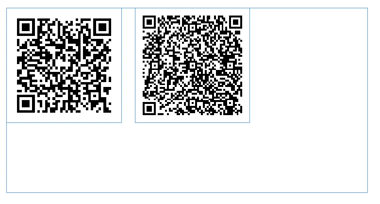

I need two URL link QR codes on the same page, side by side. Since the URLs differ in lenght the two codes are just different enough in size that the alignment looks off. There's no way to fix this or is there?
Is there no way to crop the codes' frame to their actual dimensions or pull them out of there somehow?

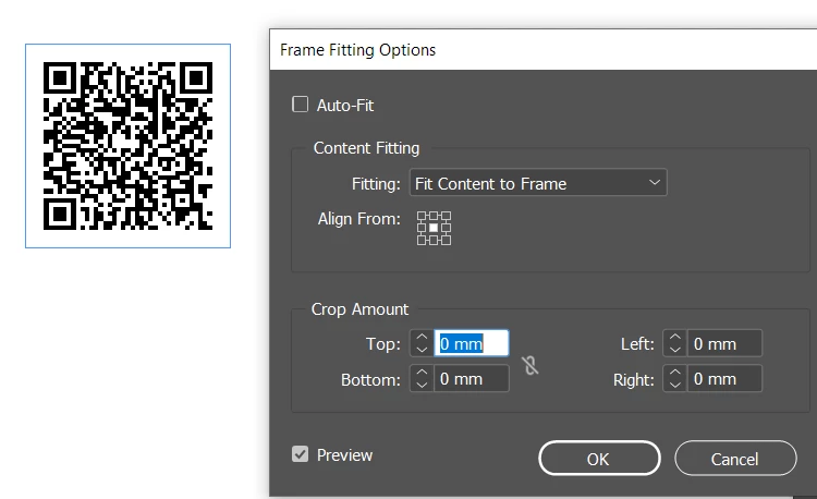

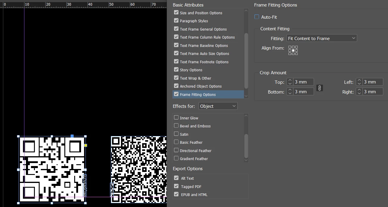

As mentioned they are just in graphic frames
In the file I sent you

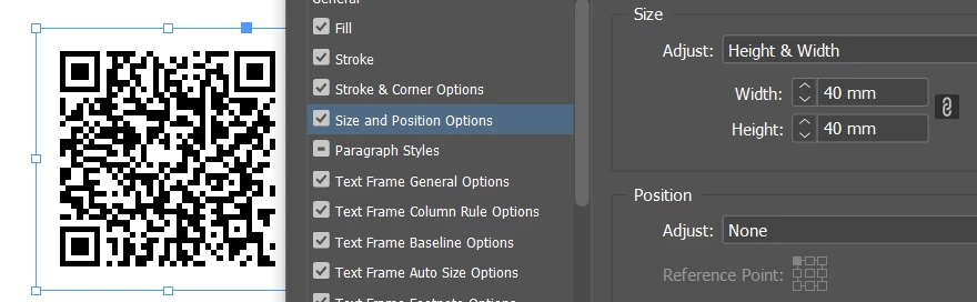

Go to Window>Styles>Object Styles
You'll see the QR ObjectStyle I created
And increase the crop amount
This gets it close to the edge of the frame.
It's not perfect. But I assume as you do it's to do with a hidden setting for a quiet zone for the barcode.
If it's that important then I really think you should find a QR generator that can do what you need.

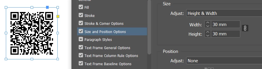

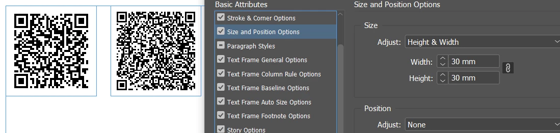

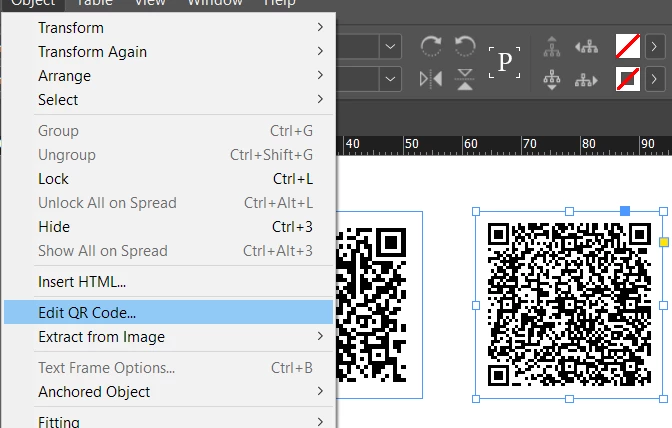

Create 1 QR code at the size you want
Set the Frame Fitting Options
Duplicate the QR code
Go to
And insert your new URL.
You can set the QR code frame as an Object Style
So if you wanted to increase or decrease the size you can easily
And it would apply to all QR codes.
Spacing might be problematic - but you could anchor the QR codes in a text frame.
And then the spacing would be the same all the time.
