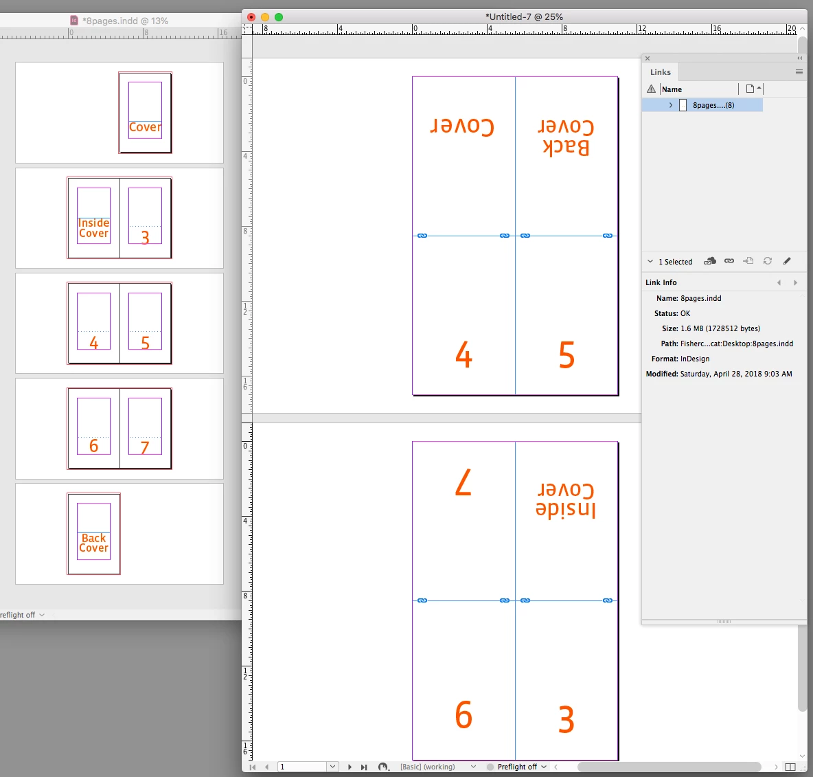

    rob day
    April 30, 2018
    This project is for a book history activity in which my students will be folding sheets and then stitching together their own quarto books, as it was done in the early days of print.

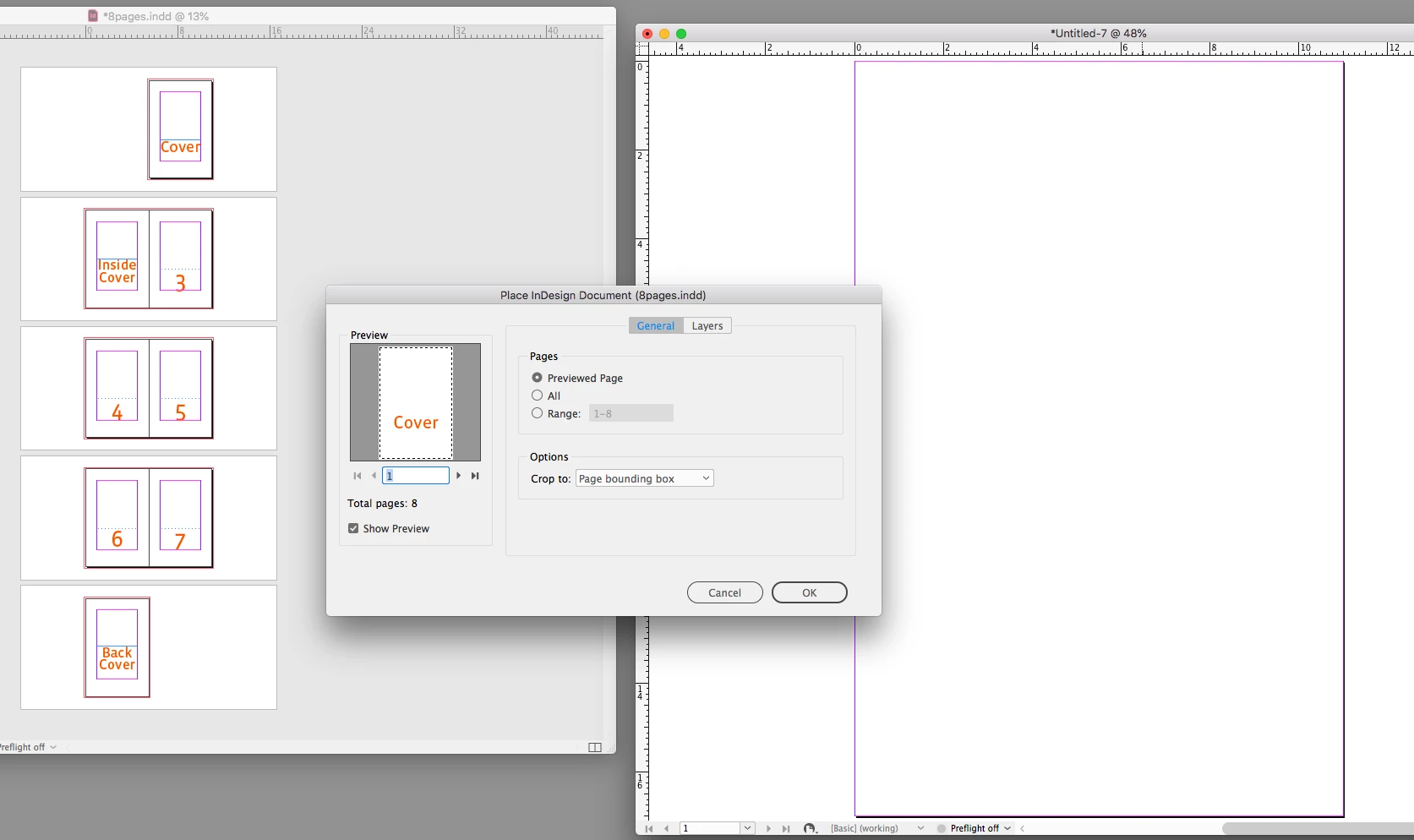

    If you want understanding imposition to be part of the book project, you can make manual impositions by placing InDesign pages in another InDesign document. So here I have an 8-page reader document on the left and I'm placing its pages on an 11" x 17" doc—choosing Show Options from the place dialog lets me choose the page to be placed. After the place I can rotate the pages as needed.
    Once the imposition doc is setup, I can make changes to the reader doc and simply update the link in the imposition doc.
