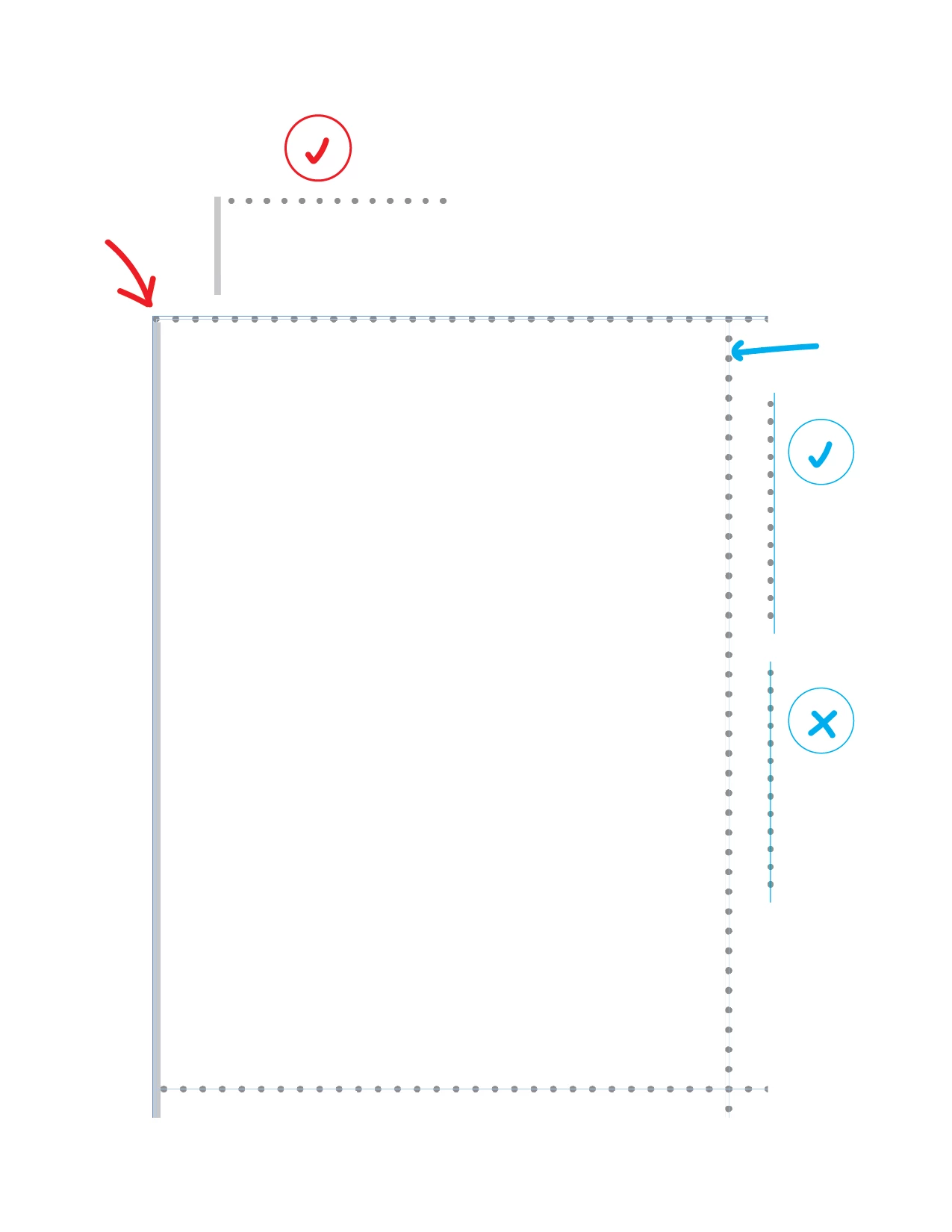

Hi there, I'm wondering if the following problems can be solved.
1. How can I adjust the placement of the corners on dotted lines so that they start after the solid line?
2. How can I align the dotted stroke to the inside in such a way that when I enter the exact size, the table will fit within the margin?
Thank you in advance!

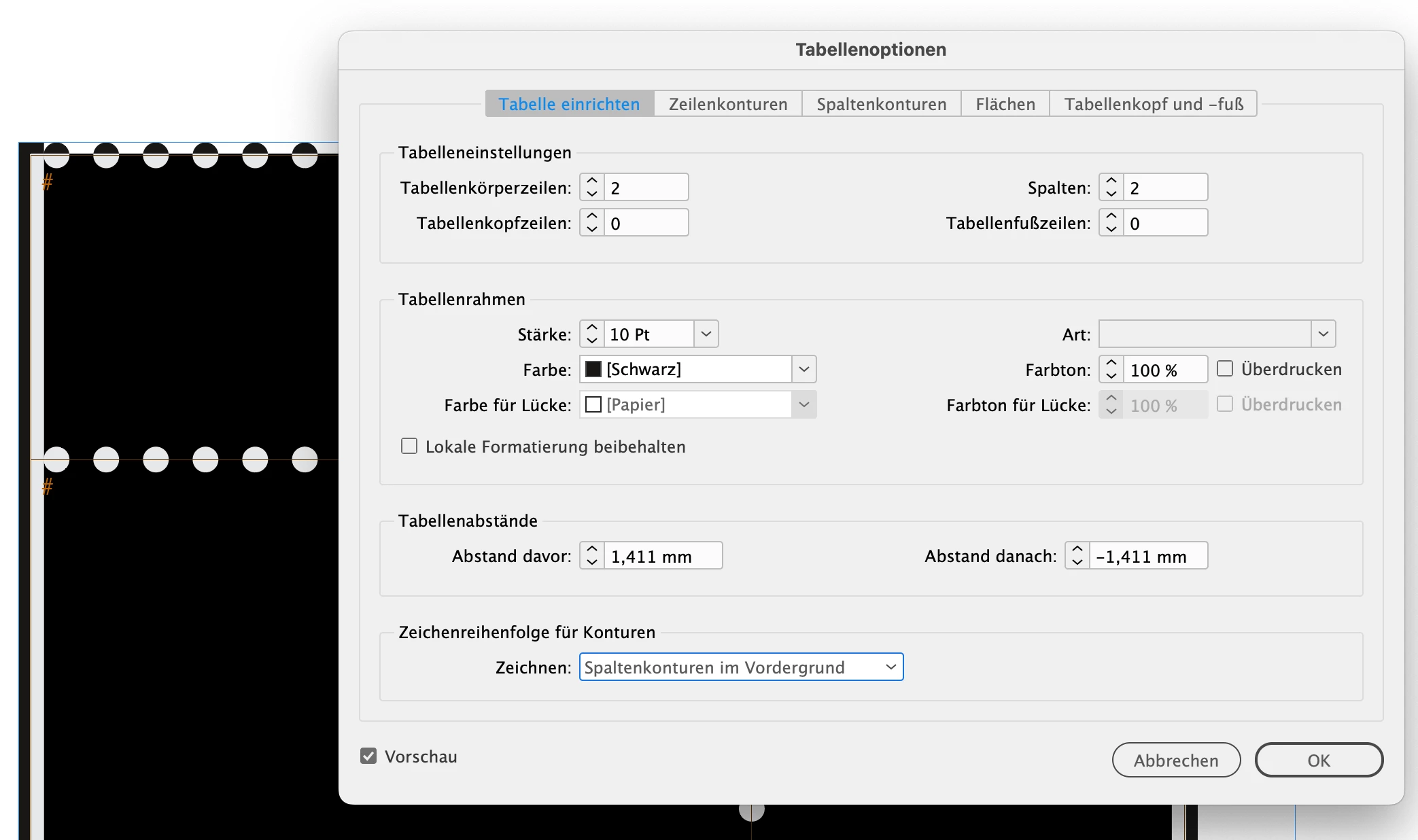

[1] You could try to change the table property Stroke Drawing Order:
Change the default "Best Joins" to "Column Strokes In Front".
From my German InDesign where I changed the table's stroke drawing order to "Column Strokes In Front" ("Spaltenkonturen im Vordergrund")

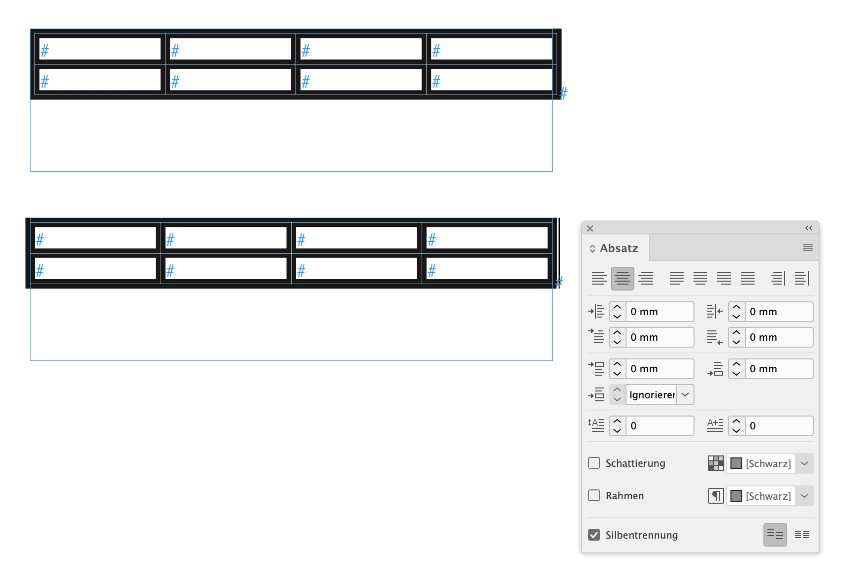

[2] The strokes' alignment for text cells is always "center". And that is center to the cell's border.
If you start out with a table that sits in a left aligned paragraph the start of the left outer stroke aligns with the text frame's left edge. So to fit the table to margins you have to do a little math.
Change the width of every column a bit so that you factor in half the width of the left outer stroke plus half of the width of right outer stroke.
Or you decide to have a center aligned table in the paragraph. Set the paragraph that holds the table to center aligned.
Then the table would extend both edges of the text frame a bit; just half of the left outer stroke and half of the right outer stroke if the sum of all column widths is the width of the text frame.
