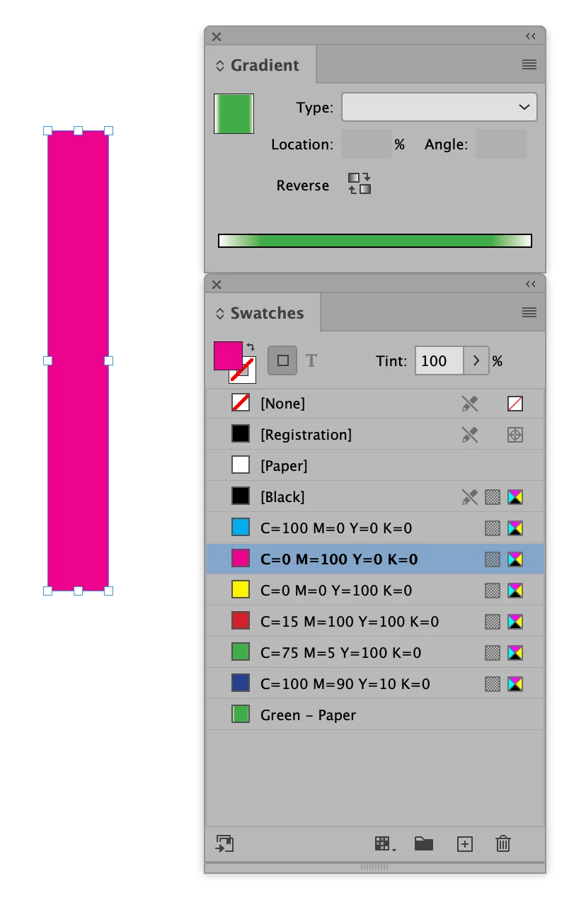

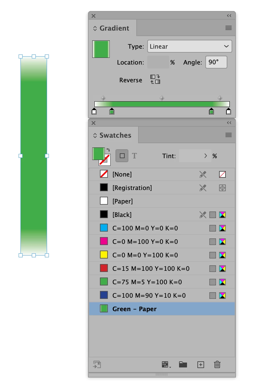

I'm going to assume that you created the gradients in InDesign. You create them by choosing New Gradient Swatch from the Swatches panel menu (Window > Swatches). Then you may have picked solid colored swatches of green and Paper colors in the Gradient panel (Window > Gradient) and applied them to the bar at the bottom of the panel. Each color stop (looks like a little house) represents a swatch color. I had to rotate the gradient 90 degrees (also on the Gradient panel) to get it to run the length of the rectangular shape:
To see what gradient swatch is applied, use the Selection tool (black arrow) and if the Gradient swatch was saved it should appear in the Swatches panel. I named my gradient to make it easier to recognize: Green - Paper color.
To change the rectangle from gradient to solid color, you must select the rectangle with the Selection tool and choosing one of your solid color swatches:
