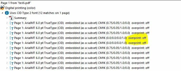

I have a similar problem as the initiator of the conversation. What it means when an analysis from Adobe Acrobat means "overprint: on". Does the printer reprint the same line? How can I fix this problem in InDesing text?

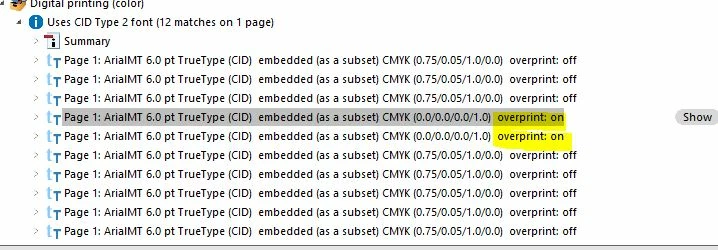

KajsaKooCorrect answer
February 17, 2022
Hi again!
I think I found a solution from here:
https://support.jukeboxprint.com/hc/en-us/articles/203297856-Overprint-Error
I checked both settings and I had to disable  "Overprint [Black] Swatch at 100%".
Here is the analysis again:
