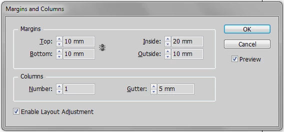

    Did You try to enable Layout Adjustment prior to changing margins on master pages?
    Screenshot is from CS6, so it might be not exactly what You see.

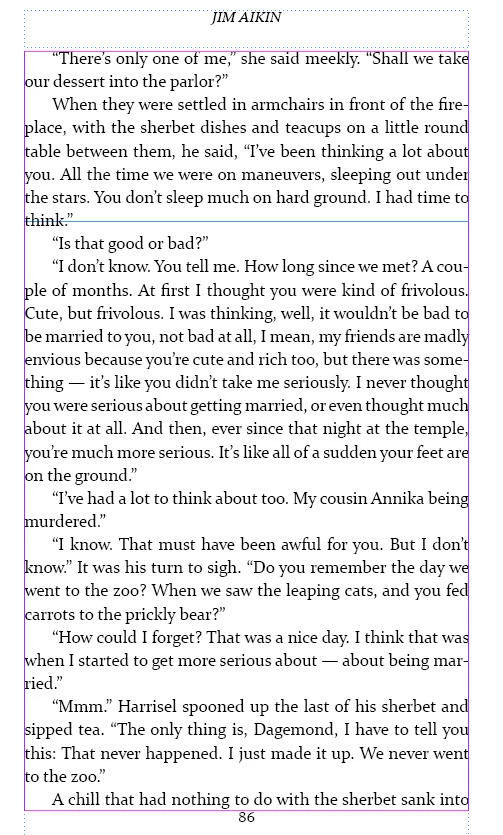

    That has no effect. I tried switching it on (it's a bit different in the 2017 version, as it's in the Liquid Layout toolbox). All that happens is that I get a line across the text on every page. I adjusted the top margin down radically to demonstrate this, as shown below. The line through line 8 of the text is what I get. I made this adjustment on the Master Page -- and it does nothing.
