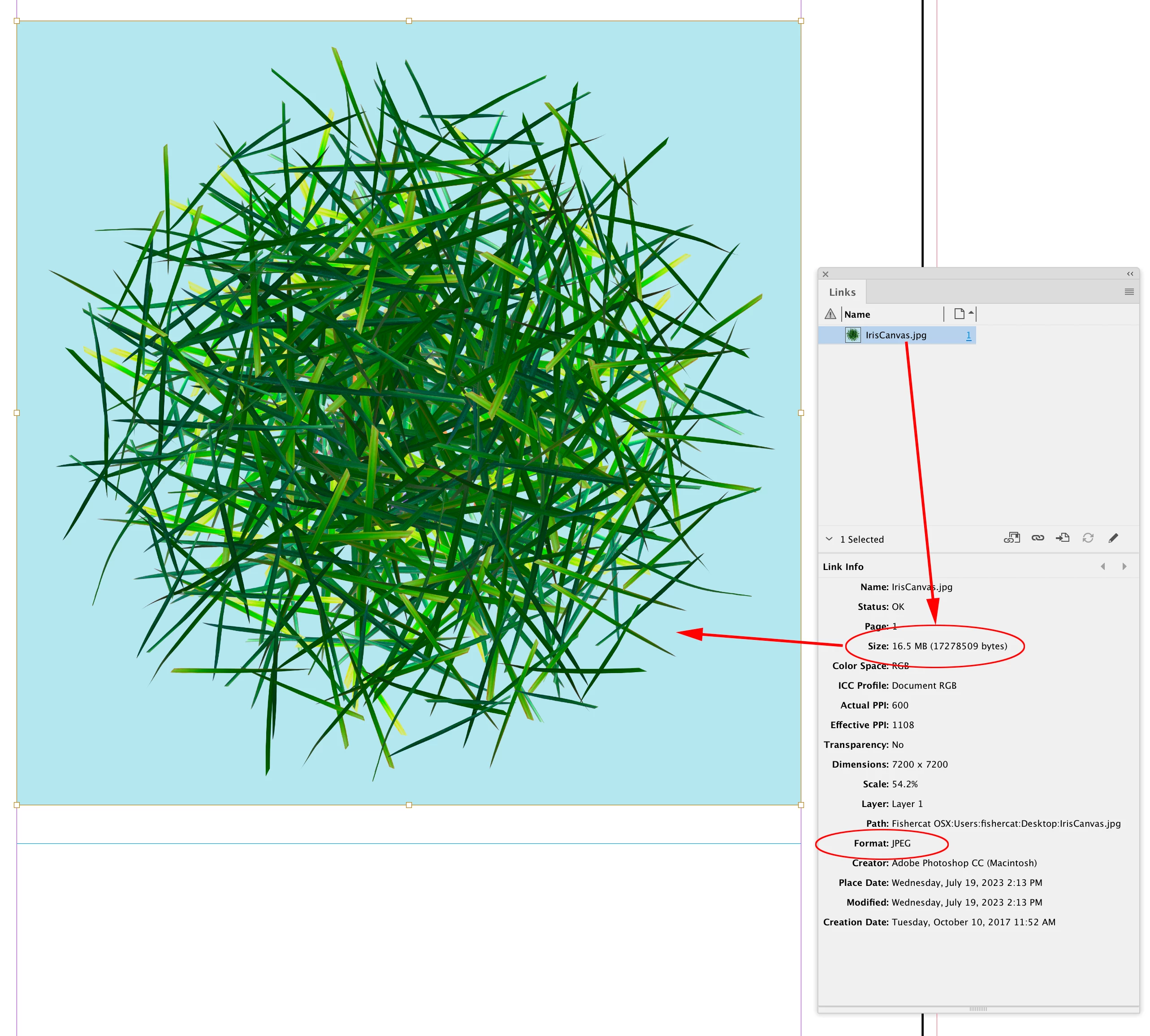

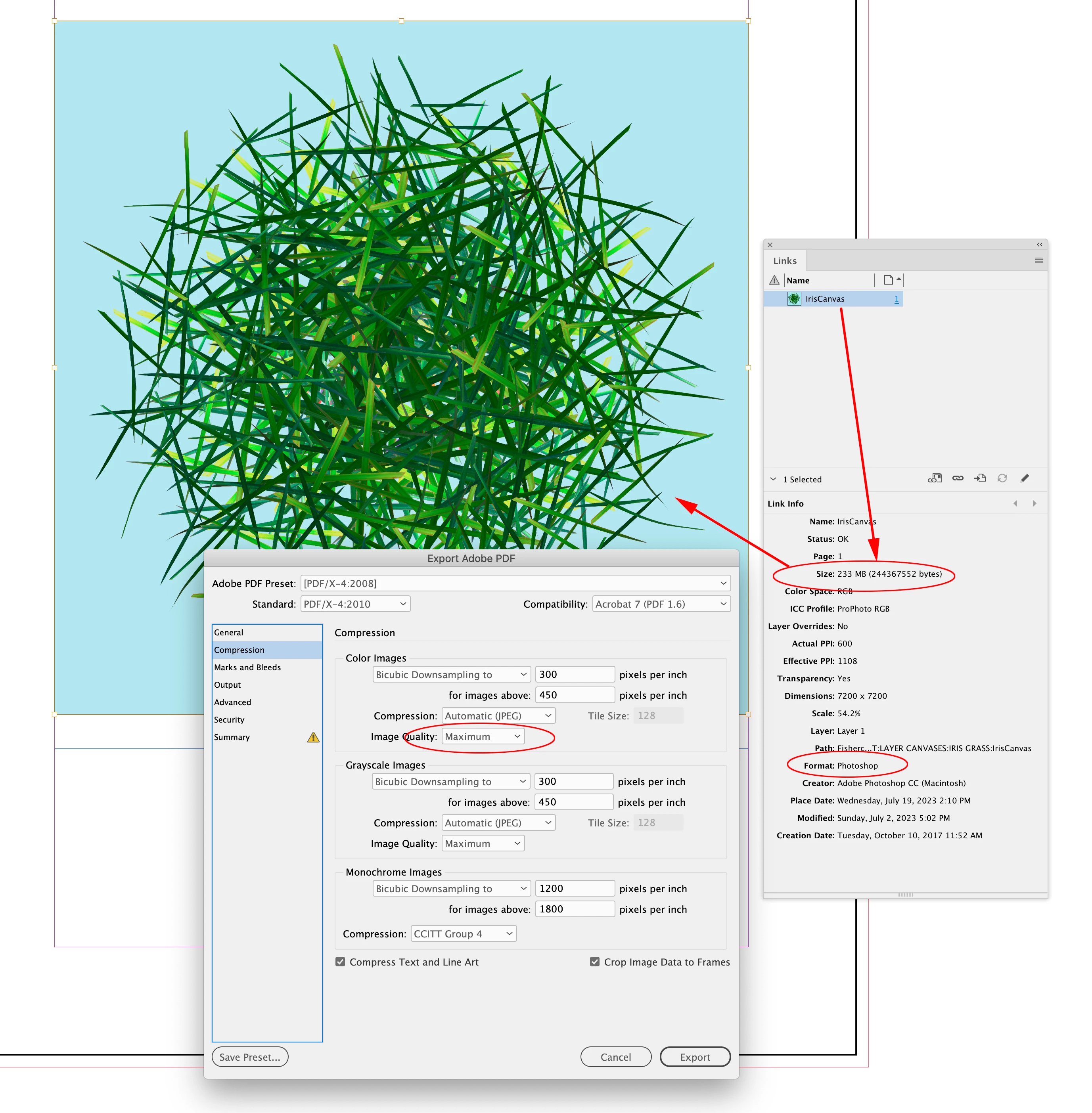

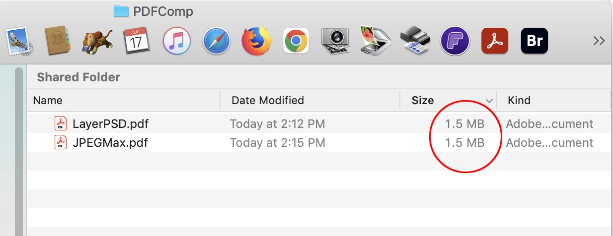

Here’s a file format compression example. This page has a 233MB, multi-layered, .psd file placed. If I Export to the default PDF/X-4 preset—Maximum Quality JPEG—the exported PDF is 1.5MB:
If I place the same file as a high quality .JPEG (16MB), the exported PDF is also 1.5MB:
