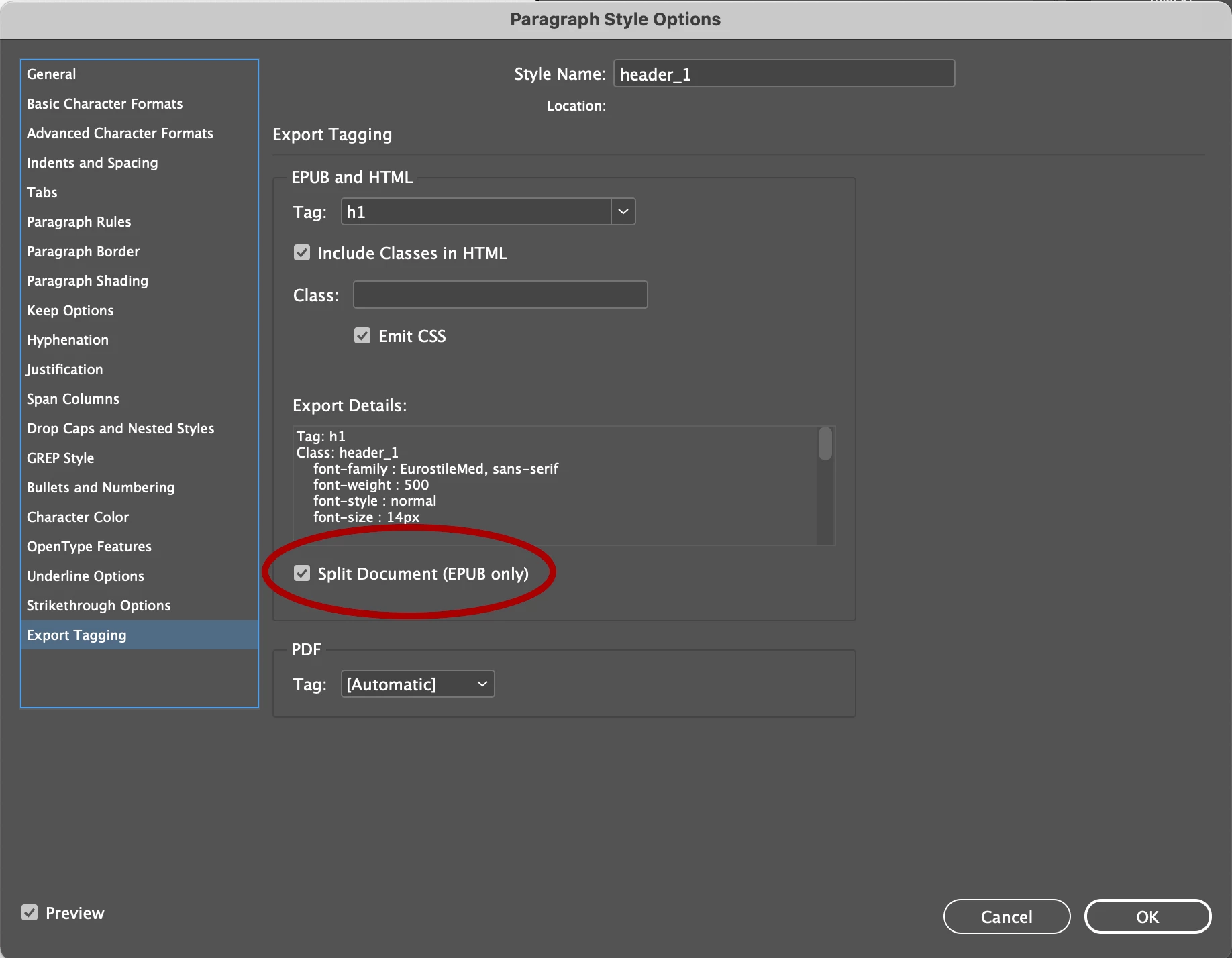

January 28, 2022
I'm testing it in Apple Books and in Thorium (my Windows 10 machine)
The screenshot is the paragraph style I'm using for my chapters and page breaks. This style is also used for my toc.

James Gifford—NitroPress
January 28, 2022
Okay, that.
Don't use the split document feature. I suspect that will solve your problem. Split Doc only works when you want almost wholly separate sections, without links. They work in theory, but...
