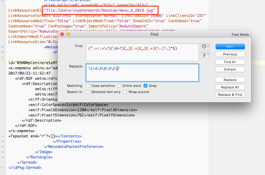

3. Editing the …Spreads\Spread_uc6.xml file using BBEdit, I used a regular expression find/replace to change the image names:

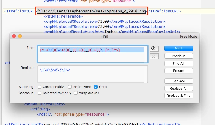

4. Editing the …META-INF\metadata.xml file using BBEdit, I used a similar but slightly different regular expression find/replace to change the image names:

6. Opening the edited IDML file, the links are now renamed and missing, which was the whole idea. Although I have only used 2 images in this example, the process is the same for 2000 images, as long as the original filenames match the regular expression, then the find/replace pattern can be used to mass update all links. Otherwise you will need to run separate find/replaces using different regular expressions to batch change all of the image names.

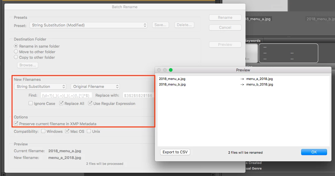

7. Using Bridge’s Batch Rename tool, rename the images using a string substitution regular expression:
8. Opening the same IDML file again into InDesign after renaming the images, the links are all good and no longer show warnings:
