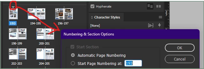

The only process I can see is to open the component chapter (numbered 121-140 by the Book process), click on the arrow above the first page in the Pages pane, and set numbering to "Start at [1]."
You could export from there and then exit without saving to keep from disturbing the Book numbering.

That's what I ended up doing. Thx for your input.
