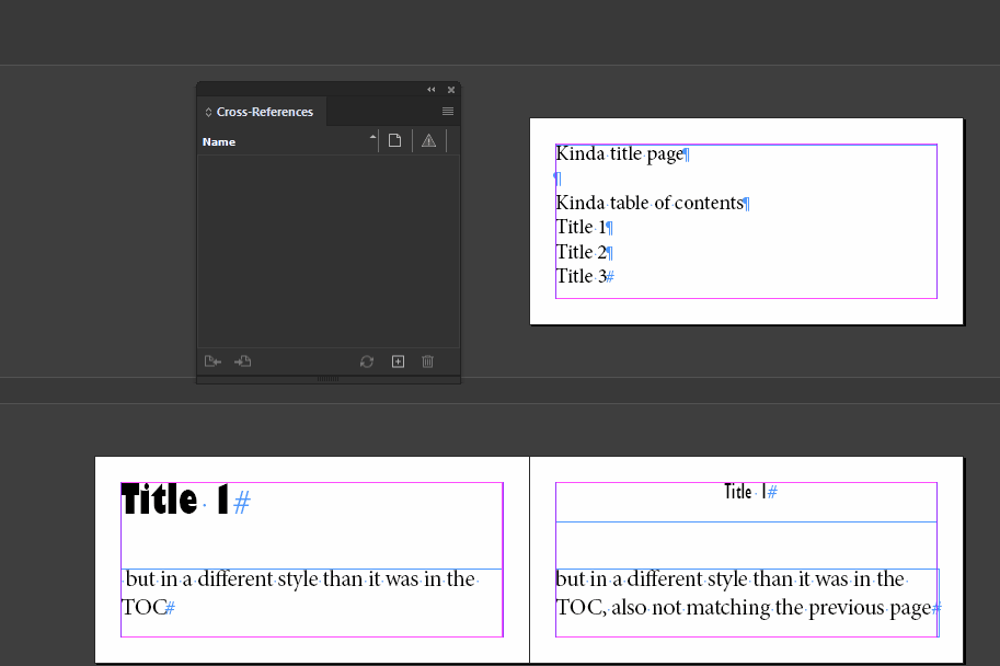

Hi all,
I'm trying to create a mini textbook and would like the titles and subtitles of each unit to be repeated in different text boxes, with different paragraph styles, in different places across the document.
The cover is a kind of title page with it's own master and a kind of table of contents.
The spreads are the different units, with their own master design.
I've tried using a running header, but this doesn't work unless it's on the same spread.
I've tried using a custom text variable, but the text doesn't wrap properly for longer texts.
I've tried using the content collector, but the paragraph styles are also copied.
Ideally, I'd like to be able type in the title and outcome on the 1st page of each unit and it be repeated where necessary.
I've attached some screenshots to help visualize the project.
Thanks

I am surprised that the running header doesn't work for you; it's pretty configurable. But if running headers won't cut it, you could use cross-references with a custom cross reference format:
Note that I had to edit the "Full Paragraph" cross-reference format to remove the quotation marks, and that I saved it so that the rest of the "Full Paragraph" xrefs I would make in this document would be free of those quote marks.
June 3, 2022
Hi Joel,
That would've been perfect apart from getting an error when I try to delete the word 'title':
"The referenced paragraph or text anchor is missing."
Joel Cherney
June 3, 2022
Huh. I see what you mean! I found that I could first add to the title, then delete the word "Title," if I deleted it very carefully. That's because there is a special character being added that is needed for the xref to work. If I modify the line but leave the xref anchor in place, the xrefs are modified and can be updated, but if I delete the xref anchor, it's gone and you get a "referenced paragraph or text anchor is missing" error. Check out the special character for the xref:
