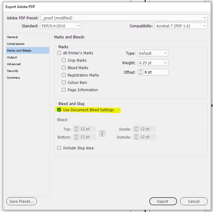

That is checked already, but the crop offset is set to 3mm (I have to have the crop offset the same measurement as the bleed). As far as I can tell, there is no way in presets to specify this. It is an absolute number, in the case of my script, the crop offset is set to 3mm. So if I have document set up at 10mm bleed, it's going to offset crop marks to 3mm, not 10mm.
Hi @danielw42205661 , Does the script below work for you?
It gets the existing "_Art" preset and sets the preset’s pageMarksOffset property to the document‘s top bleed amount—as Peter points out the page marks offset is uniform. If _Art does not exist, a new preset named _Art is made based on a chosen existing preset—[Press Quailty] in this case:

Daniel -- I don'y rhink you need a script. Simply check the option 'Use document bleed settings' in an export preset (and save the preset). Then any time you export a document its bleed settings are used in the PDF.
Does that work for you?
