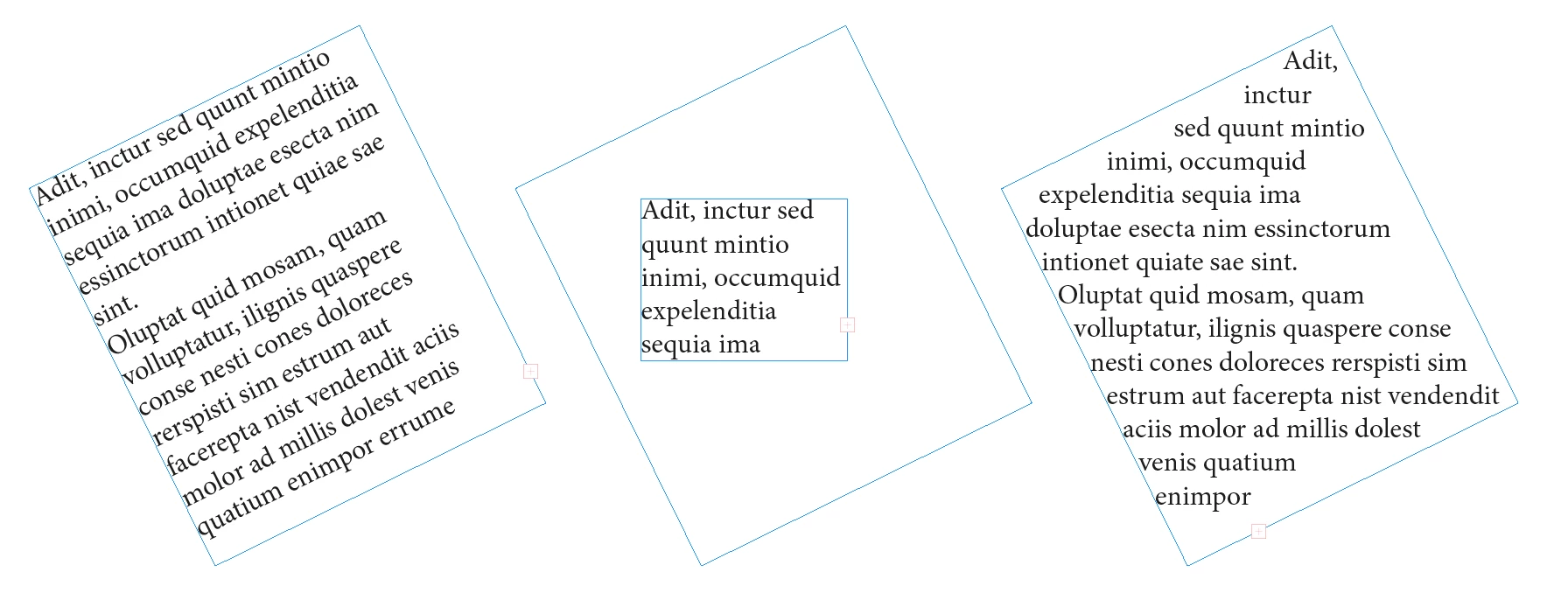

Is there an InDesign equivalent to "reset bounding box" (an Illustrator option) on rotated items? I'm working on a layout with a bunch of angled text boxes. It'd be helpful if I could change their bounding boxes to straight again, though I couldn't find an option for that. Thought I'd ask in case I've overlooked it.
Thanks, Phyllis

    Scott Falkner
    May 2, 2024
    Draw a text frame on top of the existing frame and paste the text from the rotated frame into the new text frame. Make sure the attributes for the new frame match the existing frame (offsets, columns, first baseline offset, stroke, fill, etc.). Select both frames and go to Object Pathfinder > Add.

    phyllisj9
    phyllisj9Author
    March 19, 2009
    Hey thanks,
    I'm working with text rather than graphics so unfortunately I can't rotate just the content (as far as I can tell -- not even if I convert to outlines). I tried the Pathfinder suggestion although that just turns everything into a single box (eliminates any content of the original) but did give me the idea that just grouping an empty frame with the angled one would work better. So thanks! I'd agree that it's helpful to keep a record of the rotation angle, but sometimes when there are a bunch of these, it's hard to work with angled bounding boxes. But I'll try the grouping technique -- I never thought of that!
    Thanks, Phyllis

    Draw a small box (no fill, no stroke).
    Place on top of the rotated object.
    Select both.
    Chose Pathfinder and press Add icon.
    Cris.
