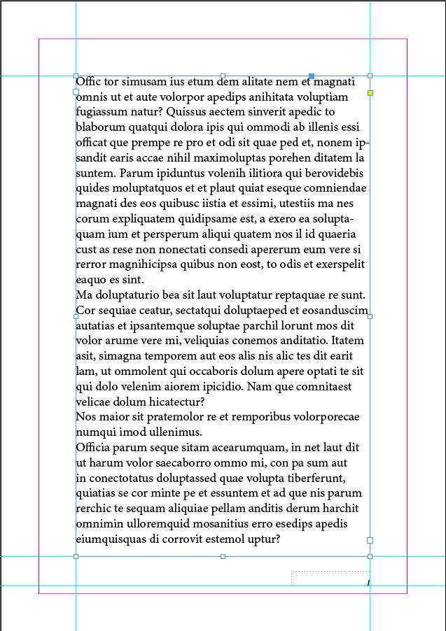

    Layout adjustment works only—this is VERY important—only, if all items align to the border margins.
    This set up will work, if I use layout adjustment:
    This setup will not work when you use layout adjustment, because everything is floating on the page without alignment to the margin guides:
