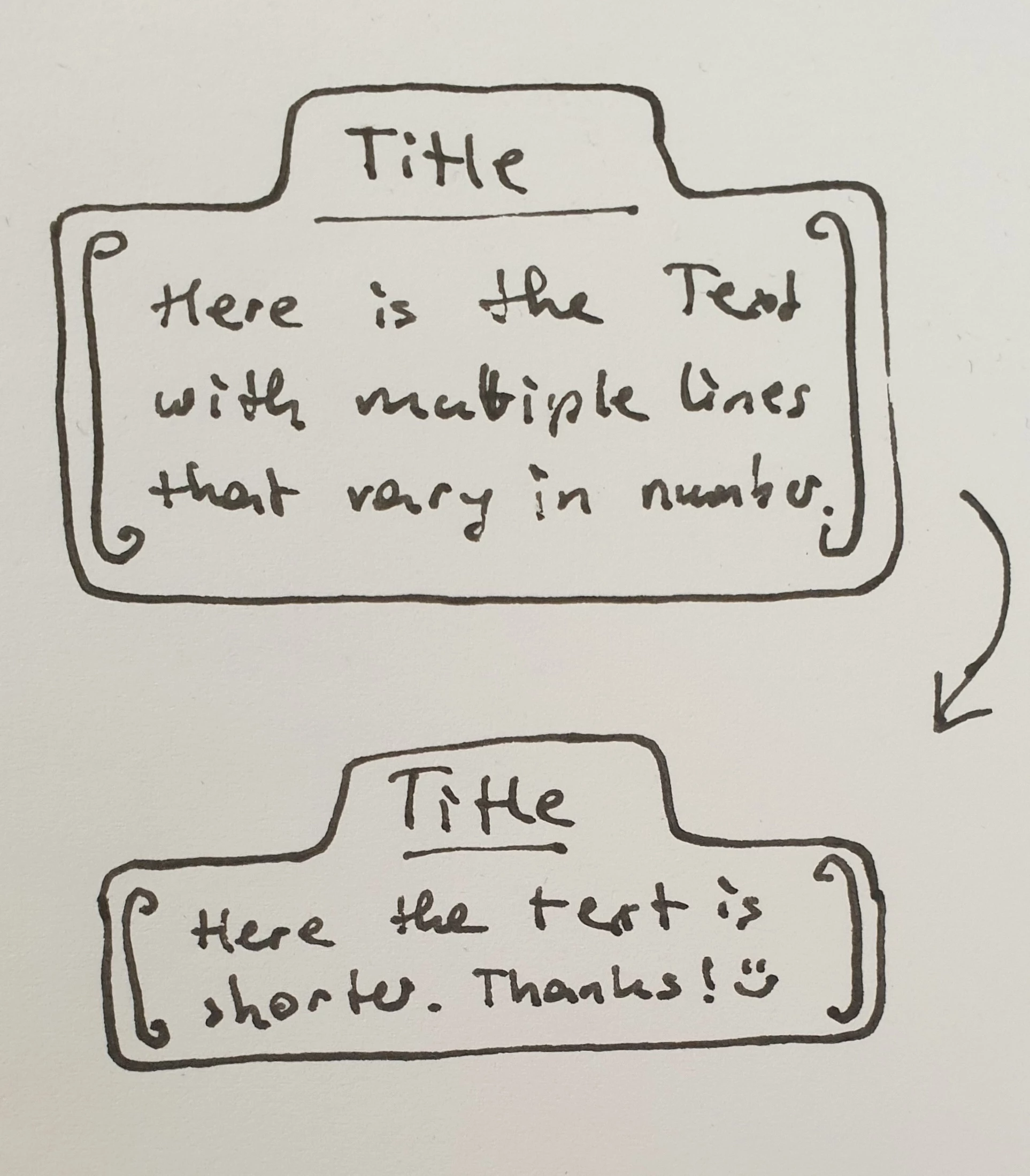

Hi!
I have a custom shape (made in Illustrator) which serves as a backdrop for some text.
I want the top of the shape to move verticall if the text has more or less lines, without distorting.
So basically, I'd need to select the top area of the box and anchor it to the text.
Is that somehow possible?
Thanks!

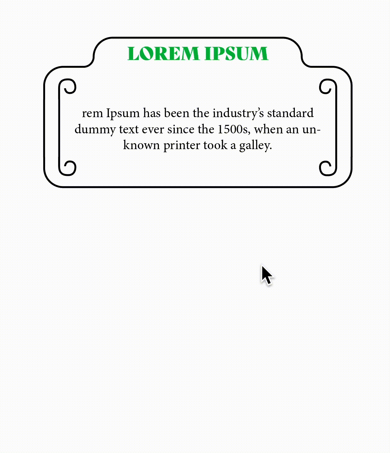

Here is the example using top and bottom with .AI art and assembled in Indesign using a table with 3 rows and 3 columns. As I answered earlier. The sides are the walls only with contours in the same thickness as the asset stroke coming from Illustrator. Here's the trick to size variation.
.Here, of course, without creating any style or large formatting. It's just to test the alternative.
After putting together the art, it becomes very practical to have an alternative to apply the texts via script or even using good old copy and paste. No major complications in the central cell of the table.

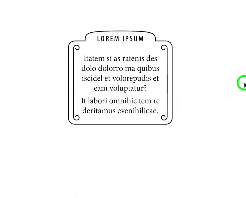

My thought was very similar to @Brito Haroldo. Splitting the frame into top/bottom. It will only work visually if your frame can overlap visually.
I've attached a little demo. I've used an anchored graphic as the first and last character of the text, tied to the top and bottom of the text box, respectively. The text box is auto-sizing. All three objects use object styles (important!).
Good: you can edit the text and the frame will adjust automatically.
Bad: the text is a little fiddly to edit because you need to not touch the first and last character. Therefore you can't use linked text.
Bad: The text can only expand or contract depending on the heights of the top and bottom graphics and the overlap. If you have two few lines of text, the bottom will break through the top, and two many and there will be a gap between the top and bottom. See video.
Ugly: the anchored objects must be "prevented from manual positioning", otherwise the text cannot be selected at all. So to adjust the height of the top or bottom anchored graphic, you must (a) select the first/last character, choose Anchored Object Options and turn this off, then edit it, then turn it back on. See video.

I'm sorry, I should clarify: I'm looking for an automated solution, where the box automatically adapts to the amount of text I have.
