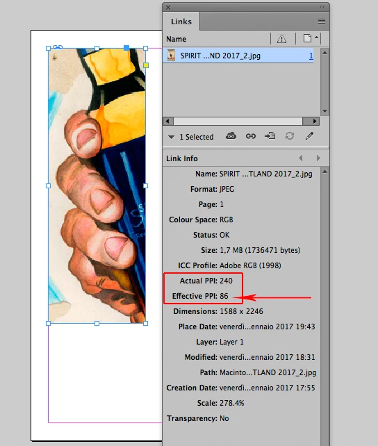

    cinziamarotta
    January 20, 2017
    Before printing it is important to check the effective resolution of the image, that obtained after resizing. You can check this value from the LINKS panel:
