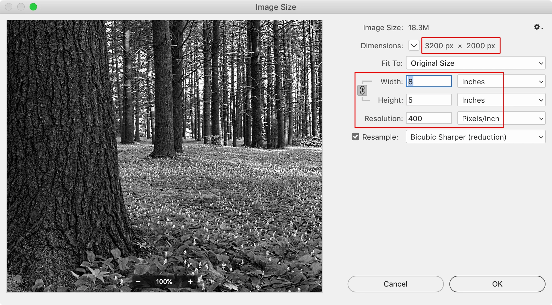

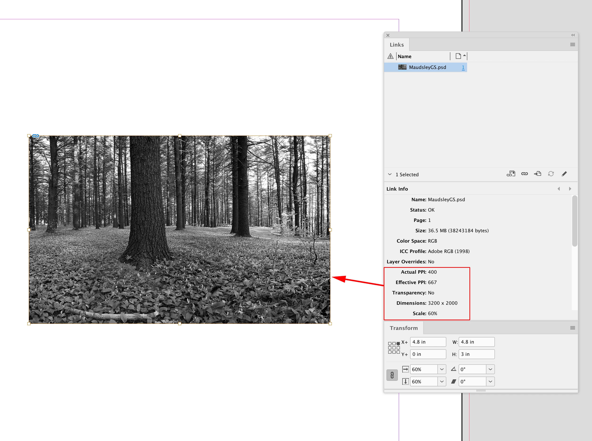

Hi @e.l , Image resolution is referred to as Pixels Per Inch (PPI). When you place an image in InDesign its resolution and scale info is listed in the Link Info panel when the image is selected—the Actual PPI, Effective PPI, pixel Dimensions, and Scale:
Actual PPI is the image resolution saved with the image. The above image was saved with an output dimension of 8" x 5" so its Actual PPI is 400—the pixel width divided by the output width as inches: 3200/8 = 400.
Effective PPI is the output resolution after scaling. The 8" wide image is scaled by 60%, so its output width is now 4.8" and its scaled output resolution is 667 PPI—3200/4.8=666.66.
The link’s Image Size in Photoshop:
