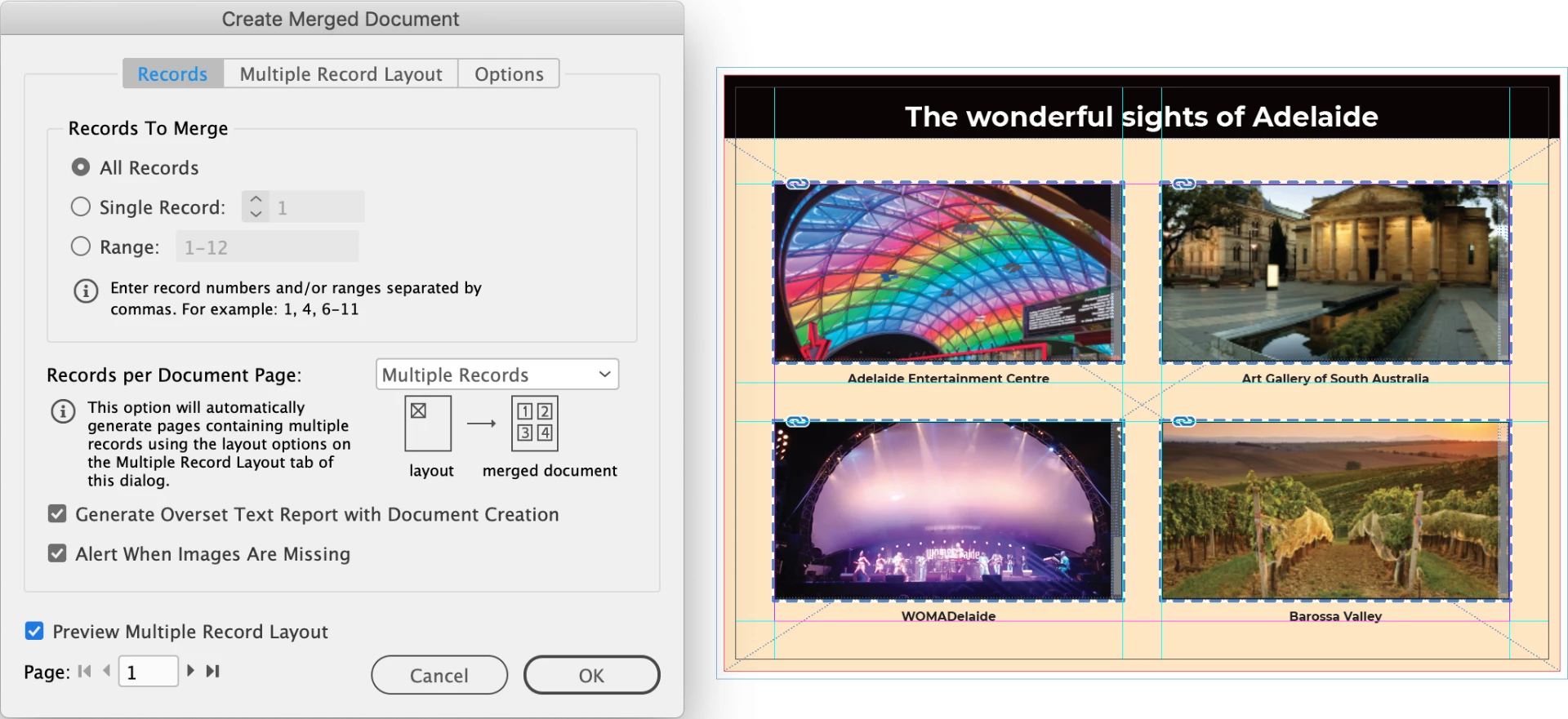

    I agree with SJRiegel, I think it's a bug. I've written a lot more about multiple record madness on my own blog: https://colecandoo.com/?s=multiple+record+madness
    That said, is the design completely on the master page, or a regular page, or the background is on a master page but the data is on a regular page? This does make a difference.
    Take the following example that has been set using a master page with a buff background, black headine with white type; and the variable data frames have been assigned on a regular page

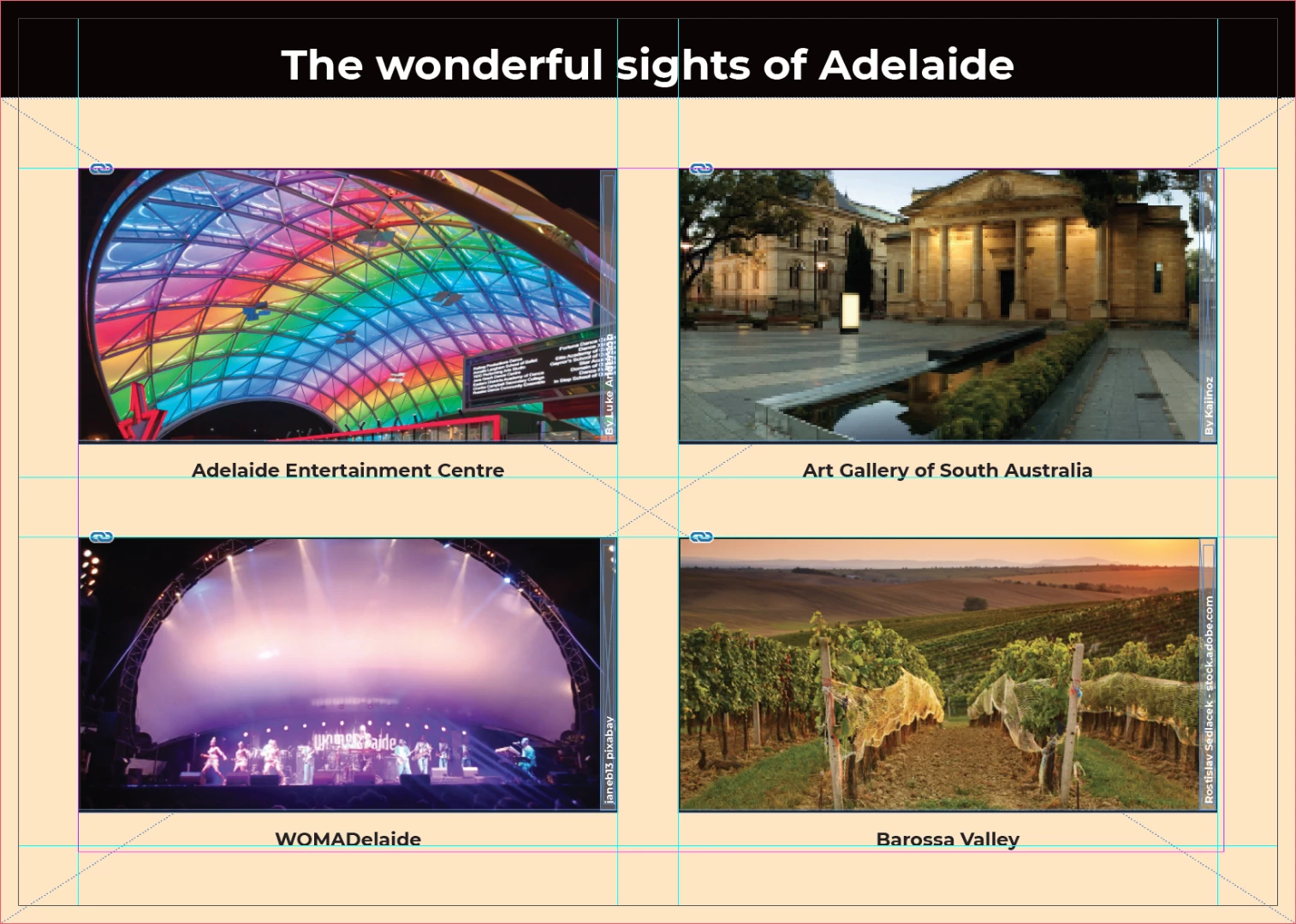

    When I preview this AND merge this, it comes out correctly:

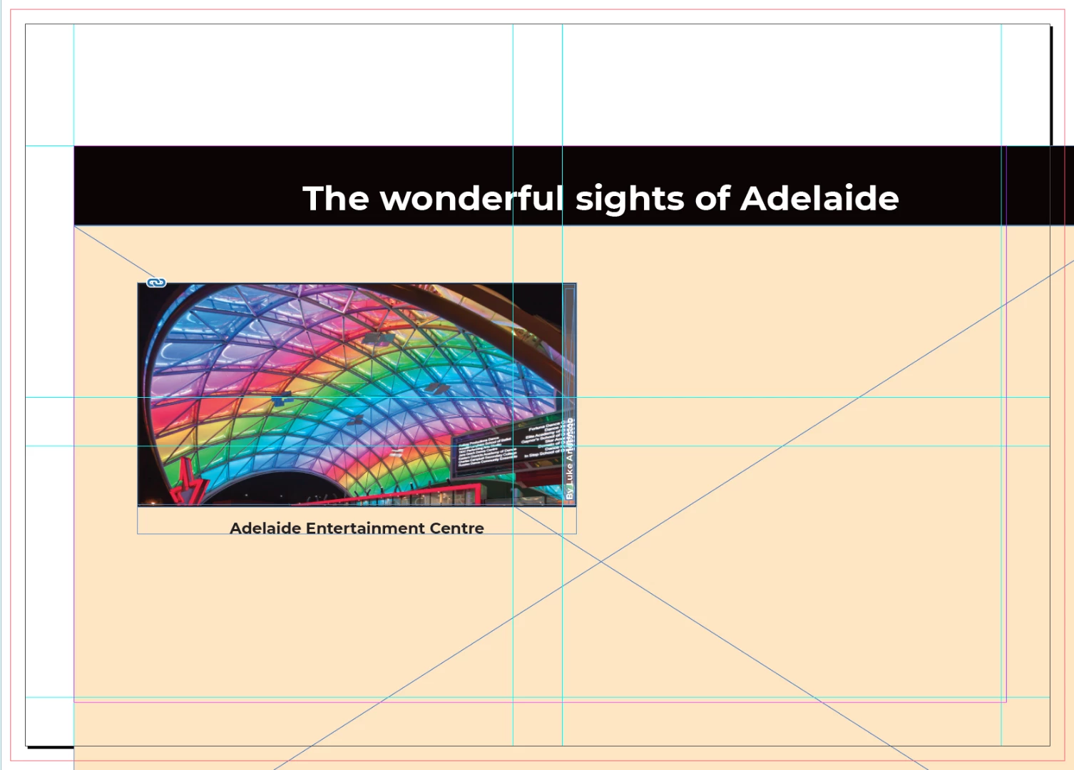

    However, when I set the entire artwork on the master page, the preview looks like this:
    but will merge like this:
    My advice is to set all non-repeating elements on the master page, and then repeating elements on the regular page.
