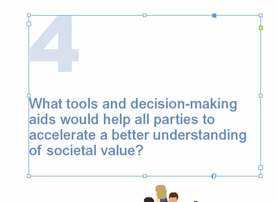

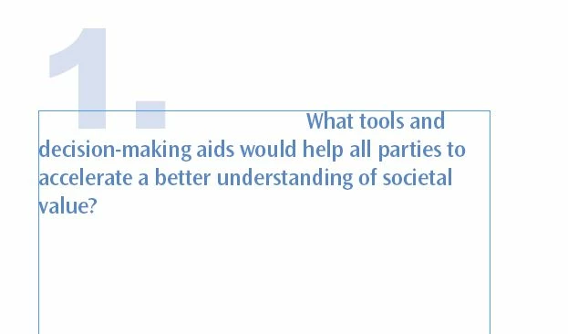

I'm trying to create the first image using numbering in paragraph styles. I can do the numbering and have a character style set for that but what I cant achieve is to have the title on the line below so ends up looking like the second image.
Aware I can probably do them as two separate paragraph style but think that may cause me issues later on with the contents page.
Thanks.

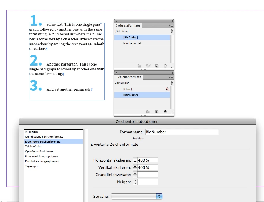

Hi James,
what did you try so far?
Here one example that would fit:
The paragraph style is using a numbered list where the number formatting is defined by a character style that is using a different font and the characters are scaled horizintally and vertically.
Uwe
February 26, 2018

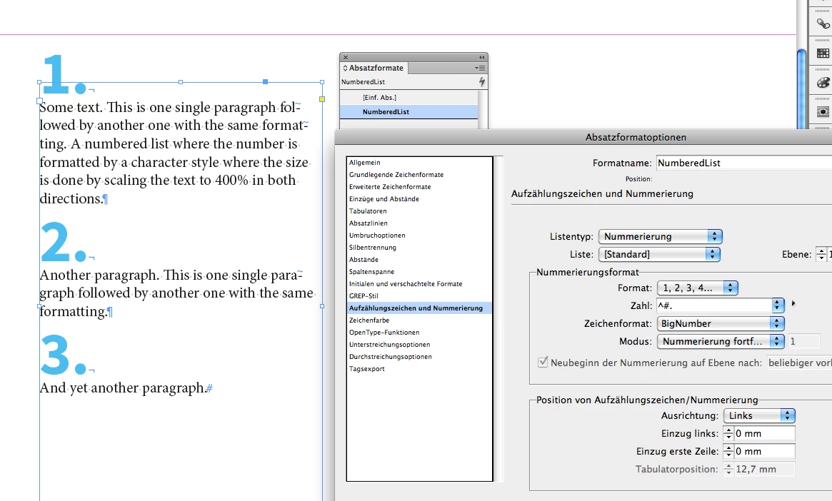

Oh. You want the first sample. Sorry, I did not get that…
You could start the paragraph with a line break:
Uwe
james_dean1986
February 26, 2018
Thanks Uwe.
Is there a way to put the line break in automatically or did you do them manually? None of the usual characters seem to work within numbering and bullets section. eg. \r or ^p
