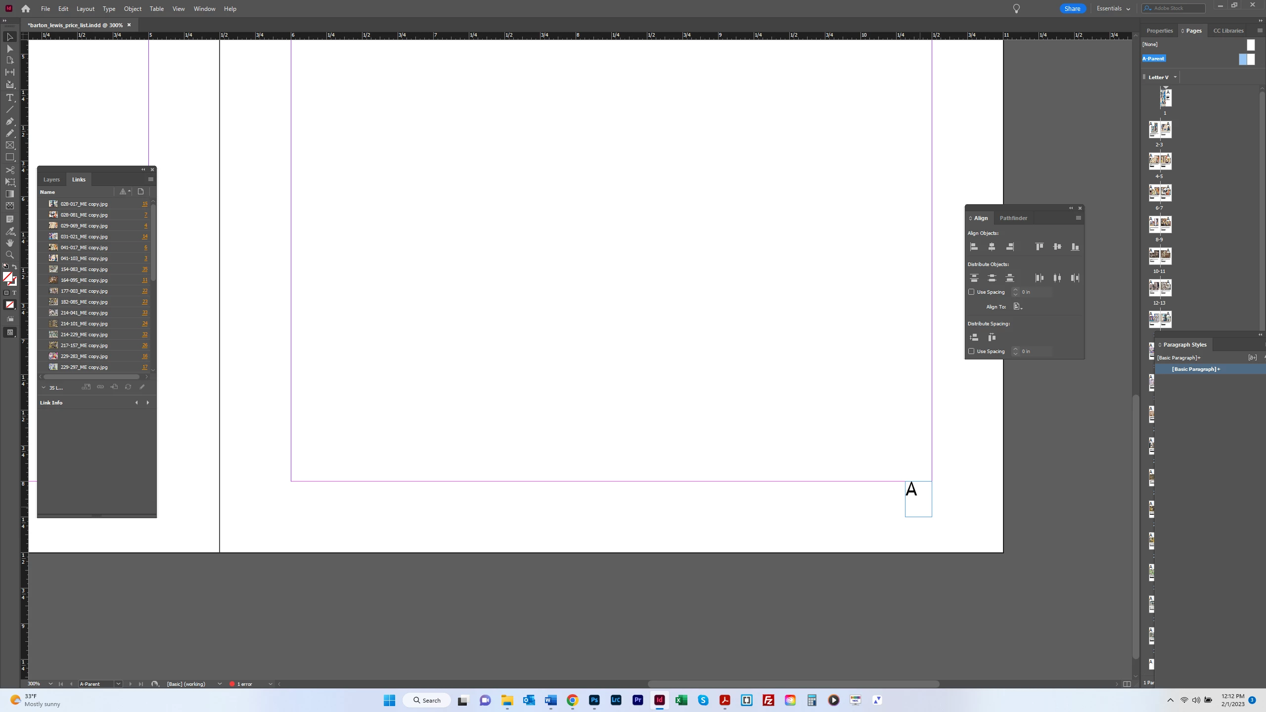

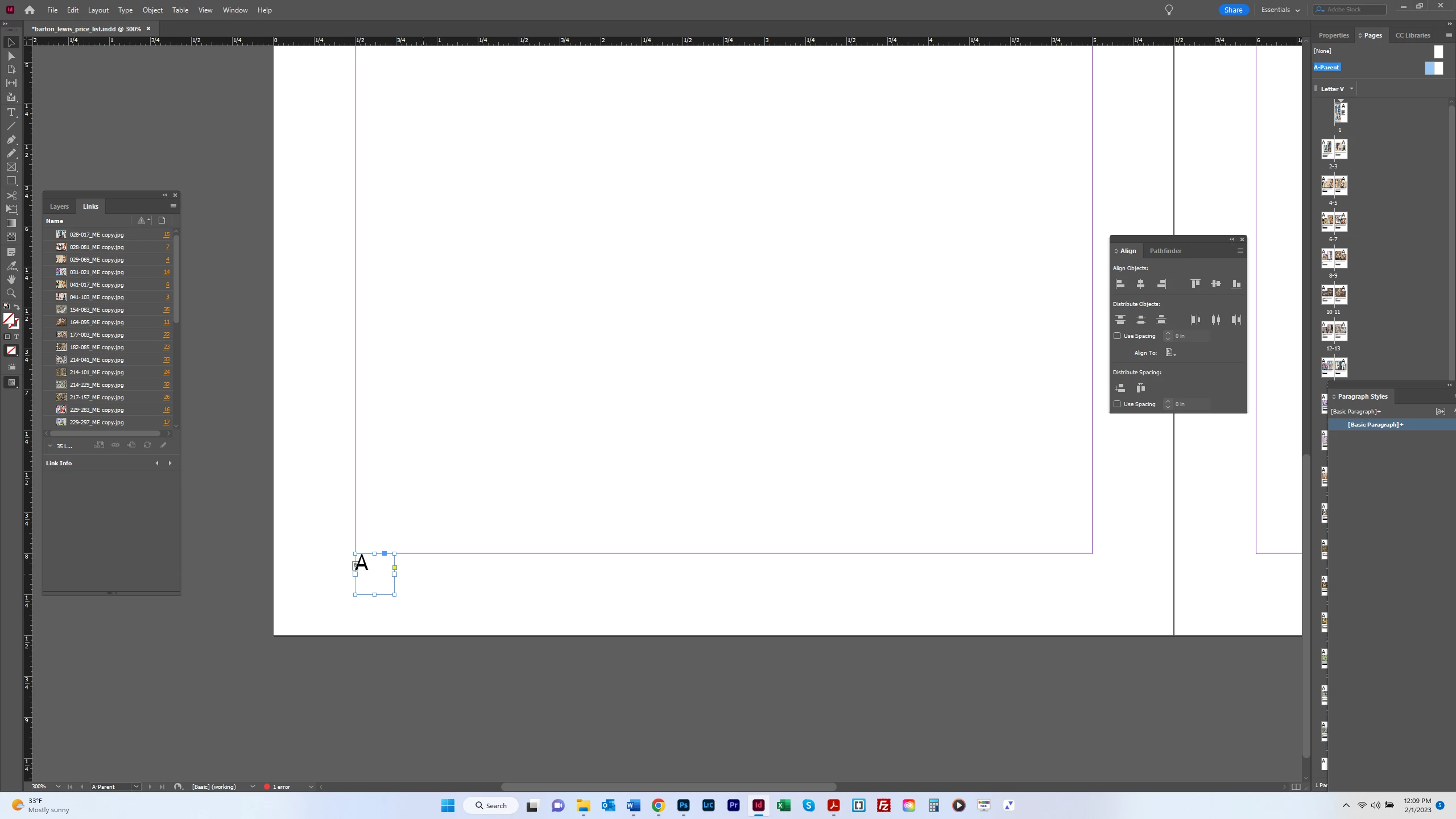

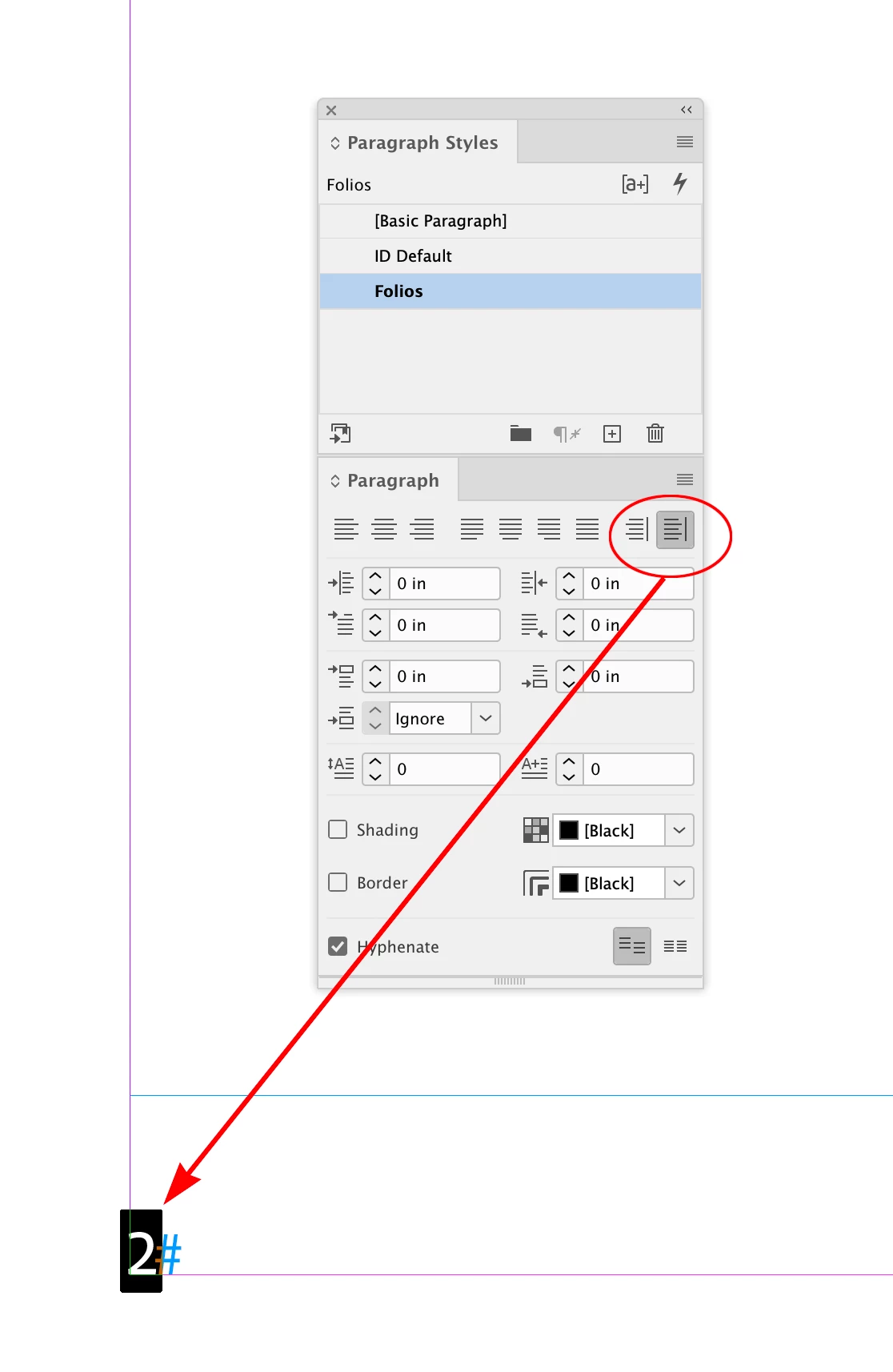

I want my page numbers to left align on the left page of the spread and right align on the right page of the spread.  Screenshots of both are below.  The left side aligns the page number correctly but the right side also left aligns the page number inside the frame, and I want it to right align.  How can I do that?  Thank you.
Correct answer rob day

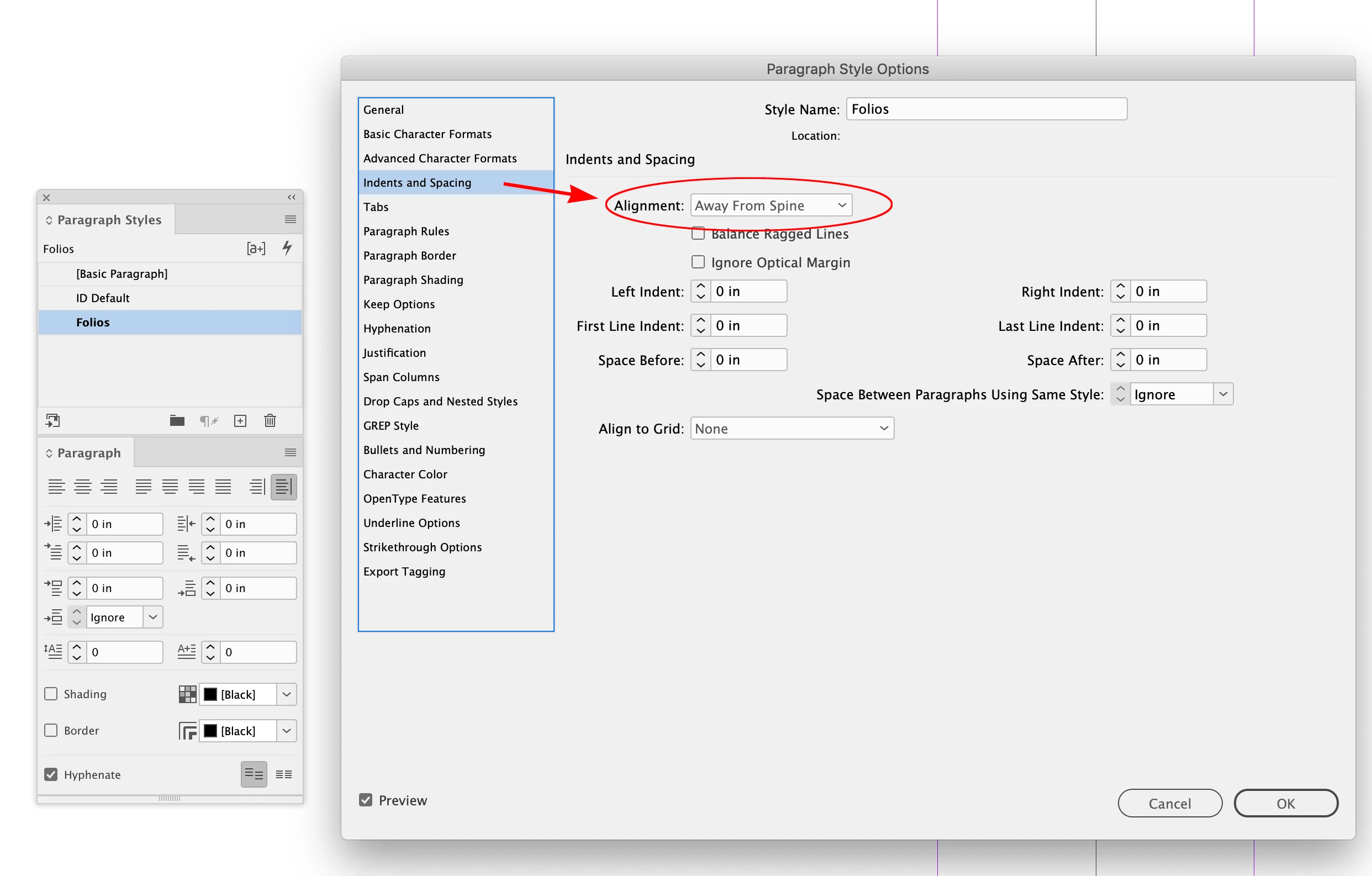

With the page number selected click this icon in the Paragraph or Control panel—by default the Contol panel is at the top of your screen:
If you are creating a Paragraph Style for the page numbers Alignment is found under the Paragraph Style Options Indents and Spacing tab:

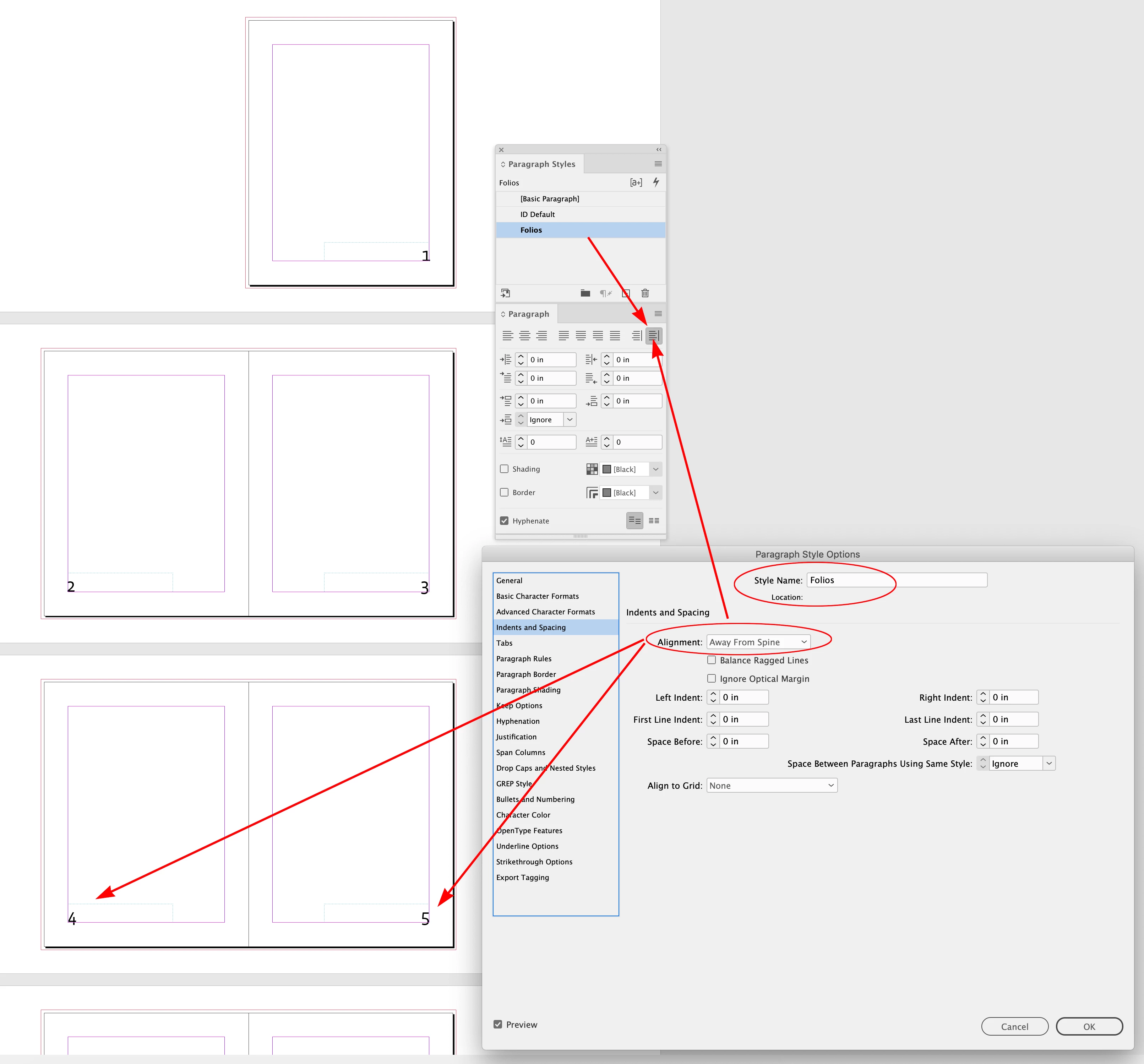

Hi @bartonlew , Also look at the Away From Spine Paragraph Style Alignment. Using Away From Spine the page numbers can have a single style definition:

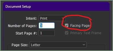

Your pages will follow that of the Parent page layout. Your document should be set up with Facing Pages checked in the Document Setup menu:

Thanks, but I'm new to InDesign and I don't know how to accomplish these things.  I checked the Document Setup and Facing Pages is checked.  Is a "header or footer frame" anything other than a frame drawn at the bottom or top of the page?  Is a "defined style" something other than a text or paragraph style?  I clicked inside my footer and selected the page number symbol, then selected Type>Paragraph Styles; I then went to the Align box and clicked on Align Right Edges but nothing happened.  What am I doing wrong?  Can you possibly post screen shots of the various steps?  Thanks.
rob day
rob dayCommunity ExpertCorrect answer
February 2, 2023

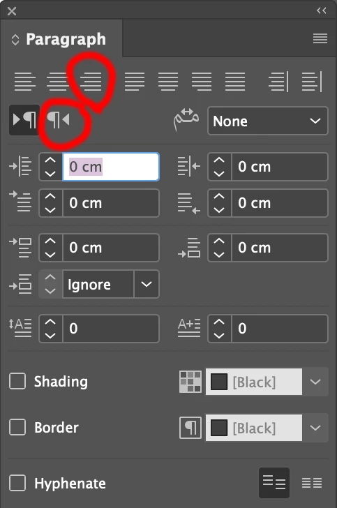

update your indesig from cc app, to support arabic language (laguages that writtien from right to left like urdo, arabic and may more.. so in the paragraph pael you will find an option to make the right umber to be aligned from right to left.
see attached paragraph panel.
