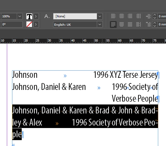

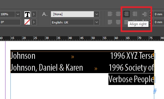

@OsakaWebbie
Like I've suspected - ALIGN RIGHT does the trick:
But there is a problem in 3rd case - too long 1st part:
Can you check length of the 1st part when exporting from a database?
And then "mark" paragraph as "fully justified with last line aligned left"?
And your idea with using Right Indent Tab - won't always work correctly anyway:

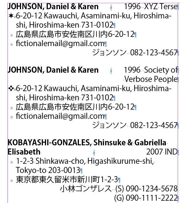

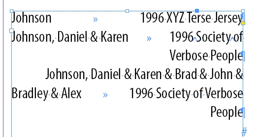

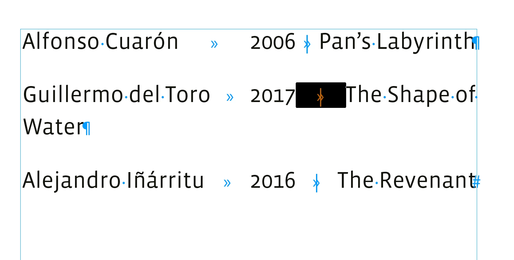

Wow, thanks to all of you who were working on this while I slept! (I live in Japan, so my timezone is probably much different from most of you.) Yes, I should have included an example screenshot - I'll do that now.
The first and second examples are how a short and long first line would look using a Right Indent Tab. (Thanks to @Robert at ID-Tasker for the ASCII code. Yes, I know I can use a normal tab with a right-justified tab stop at the column edge, but Right Indent Tab works even if the column width is changed later.)
@rob day: No, I don't want to add line breaks manually (I assume that's what you mean by "forced line break") - the whole point of this is to avoid manual editing as much as possible, as there are over 1,000 entries in the directory and mistakes are easy to make.

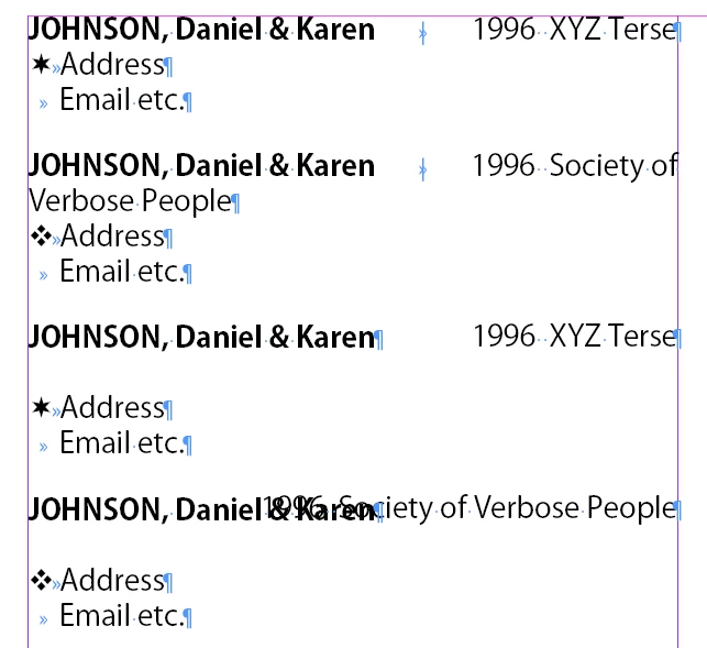

The third and fourths examples are using @Barb Binder's idea of a separate paragraph right-justified with baseline shift. At first I thought that was genious until I tried it - then I realized it has two issues, as you can see in the screenshot: (1) it doesn't wrap to avoid overlapping the name, and since the name length is also unpredictable, I can't just assign a left indent to the pstyle; (2) the next line has a gap above it. I guess #2 could be solved by baseline-shifting the Name downward instead of the Year/Org upward (since I want some space between entries anyway, although it would force the minimum space to be the height of a full text line), but how would I solve #1?

Because if everything after 1st line should be aligned to the right - you can set whole Paragraph as Right Aligned...
And you can combine it with Tagged Text - from your 2nd thread.

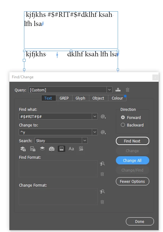

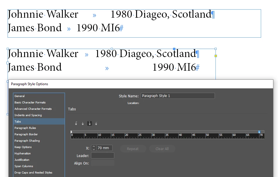

RightIndentTab - encoded as BS in black.
But you can insert anything - #$#RIT#$# - and then replace it in the InDesign - via scripting or manually:

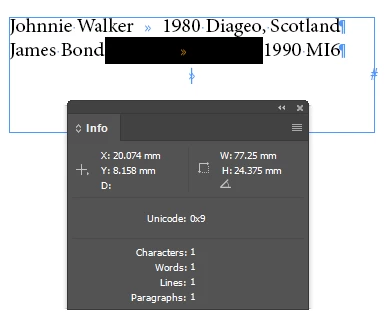

If you want to check UNICODE value of the Character - use can use F8 / Windows -> Info:
Normal TAB is 0x9 - but I'm pretty sure you know that already:

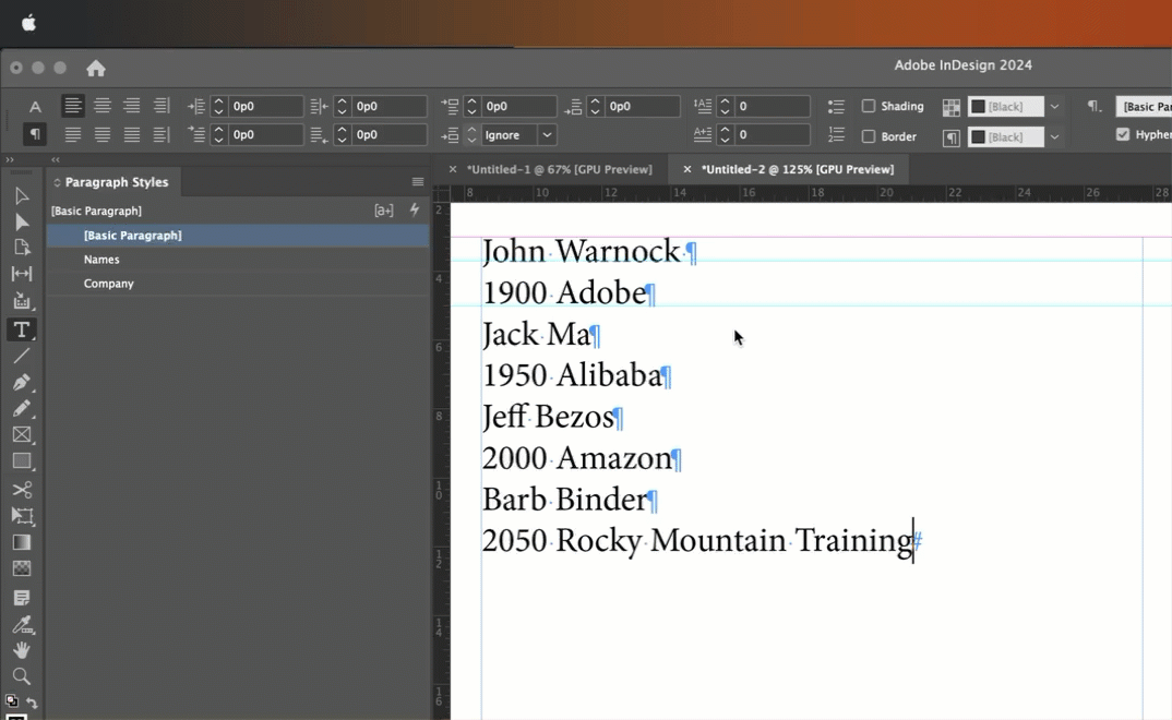

Screen shots always help—I'm confused about the placement of the year. But let's look at just the name/organization delimma.
Since this is database-driven and editing would happen in the database and not InDesign, an option is to define these elements as two separate paragraphs and use a baseline shift to place them on the same line. Then the name style can be aligned right and the organization aligned left.

TAB generated from the database will be used as per Tab Stops defined in the ParaStyle definition.

Set Tab Stops in ParaStyle definition.
