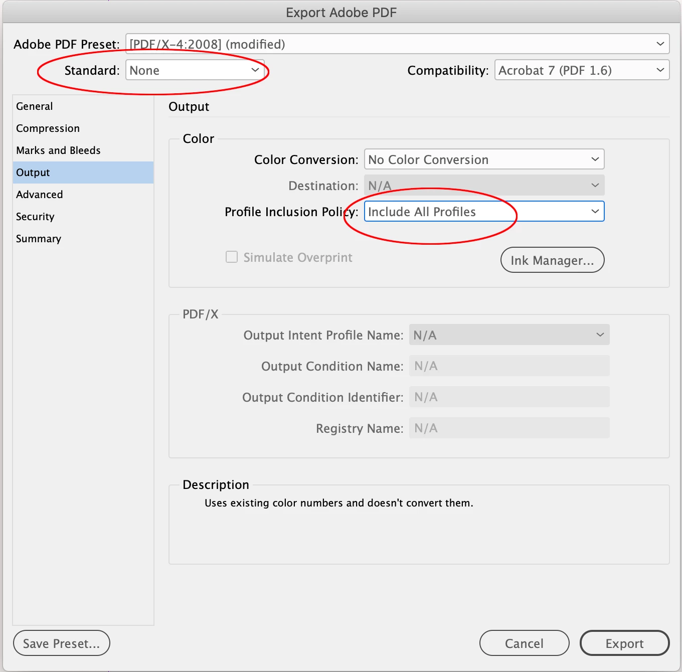

Hi @nawest , With very few exceptions large format composite inkjet printers handle final color conversions internally—the profile for an inkjet printer is very different than an offset press profile.
You are preparing your files as if they are going to an offset press running to the CMYK FOGRA39 press profile, and exporting to the PDF/X-4 press preset, which does not include profiles for document CMYK colors. PDF/X standards include an Output Intent profile, which your RIP would not likely see. So your inkjet printer doesn’t know how to color manage the CMYK colors with no source profile.
You could try including all profiles—something like this:

Thanks Rob
I suppose you could call it ignorance, but even after many years in the industry providing artwork to many clients and printers, the area of colour management is still somewhat of a grey area for me. That said, the number of times that issues have been raised in those years would imply that 99.9% of the time it hasn't been an issue.
That said, you're right, I'm supplying artwork spec'd for offset printing and not large format digital, but in my experience very few printers, litho, flexo or otherwise, supply specifications for this level of detail. They'll invariably just ask for hi-res PDFs with fonts embedded, and no mentions of standards or profiles. It's only on occasions like this whe jobs go wrong that the question gets asked.
I'll certainly send them a new test using your suggested settings though.
