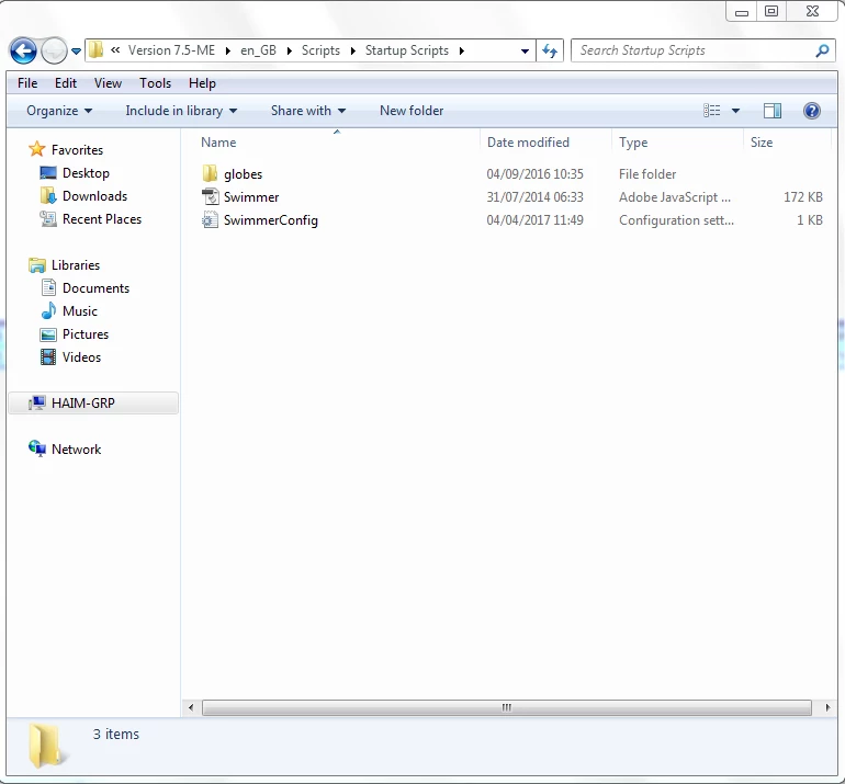

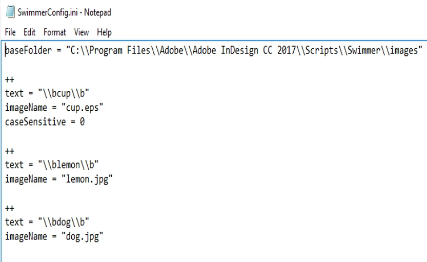

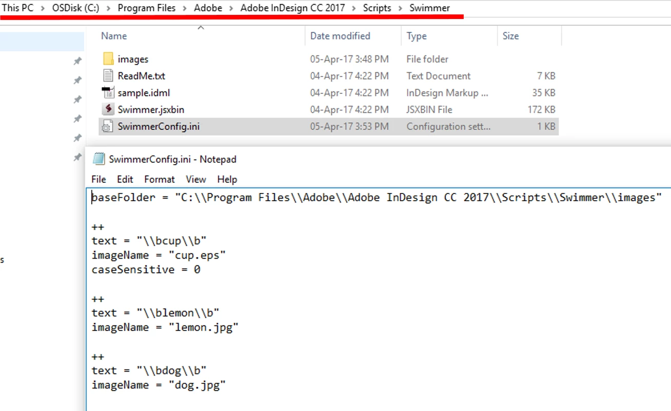

    This is my folder structure and my Swimmer.config.ini file
    This is the original swimmer folder.
    I have placed the below script in the startup scripts folder that runs the Swimmer.jsxbin file. Lets name this script as "trigger.jsx"

    Now, the "Swimmer.jsxbin" file is executed automatically when the "sample.indd" file is open. The "swimmer.jsxbin" file is written in such a way so that it executes on ALL the open document. With my script "trigger.jsx" the "swimmer.jsxbin" file is ONLY TRIGGERED TO RUN. The writter of the script "swimmer.jsxbin" wrote it in a way so that it executes on all the open documents.
    In order to check the above do this:
    1. Open "sample.idml" present in the ORIGINAL swimmer folder. This file contains the text that will be replaced by the images.
    This text to be replaced is mentioned in the ini config file. (as shown above). Do note: am talking about the original swimmer folder which is not edited by you and only downloaded from the link you mentioned.

    I did the following On Windows and it worked.
    1. Go to the InDesign Application folder ( for me : C:\Program Files\Adobe\Adobe InDesign CC 2017) and then to the Scripts folder.
    2. In the Scripts folder go to startup script folder ( if not there create one)
    3. Save your script as .jsx there. Am also adding my simple script
