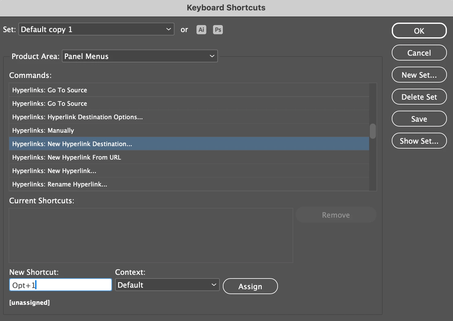

1. In the paragraph style, go to the Bullets and Numbering tab and select the following options:
  • List Type: Numbers
  • Format: 1, 2, 3, 4...
  • Number: ^#.  (make sure to include a space after the period)
  • Mode: Continue from Previous Number
2. You can create your own keyboard shortcuts!
  • Edit > Keyboard Shortcuts > New Set
  • In the Product Area dropdown, select Panel Menus
  • Select Hyperlinks: New Hyperlink Destination...
  • While your cursor is in the New Shortcut field, type your preferred shortcut (for example, Opt + 1 on Mac or Alt + 1 on PC)
  • Assign
  • OK
