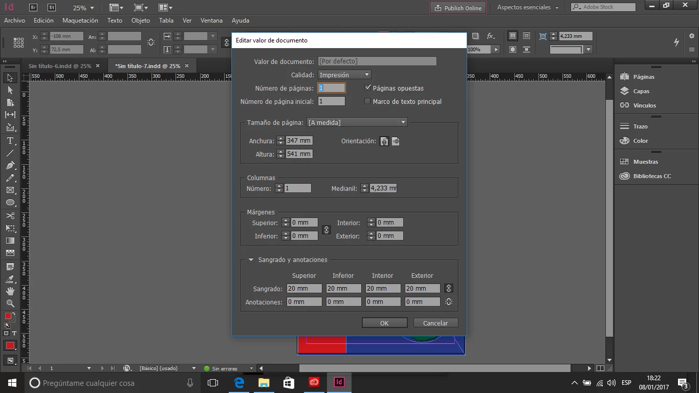

As you can see in the image that I'm posting, I'm creating a document with a specific values. The problem that I found is that when I work with de document I can't see the "Sangria", and I think maybe it doesn't appear in the image that I see, but after, when I use it for the purpose I'm doing it (It will be the image of a folder), the sangria will be incorporated. I need it, it won't work if not. So, that's my question. Have any of you know exactly how it works?

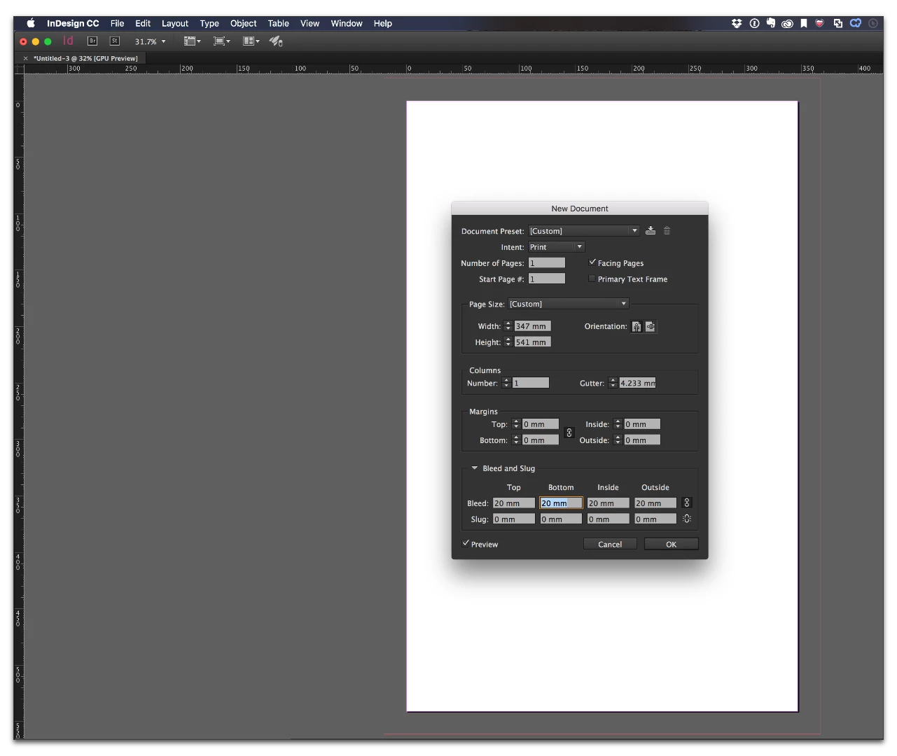

In the meantime, I keystroked your values as shown below, and realized that you don't have a margin set. (My red bleed lines are showing in the image, but they are hard to see against the dark background.)
Normally, you will want margins when creating a new document:

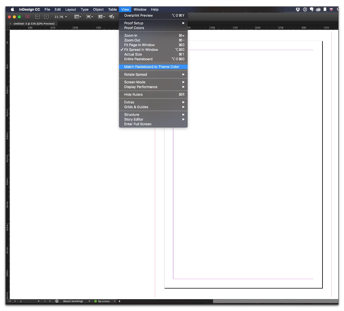

In this final image, I went to View and unchecked Match Pasteboard to Theme Color and it is easier to see the red bleed lines against the white background.
I've just solve my problem. The fact was that I was selecting the bleed in "Valores del documento" and I would have to doing it in this other option"Ajustar documento". Now is working! However thanks for everything.

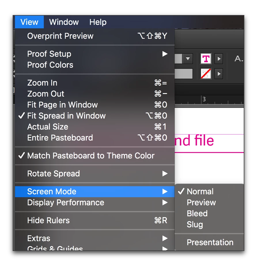

The bleed lines (Sangrado) won't appear if your file is in Preview mode. After you click OK, change the screen mode to Normal.
Barb Binder
January 8, 2017
On second glance, I can see that you are in Normal mode. Do they show when you click on OK?
blancam65307423
January 8, 2017
Not. And I cannot understand why, what actually appears are pink lines forming a rectangle and they seem like a sang. But it cannot be, because that lines appear when I chose a sang of 0mm or 20m. So, I don't know. I've tried changing the screen mode to preview from normal, and turn again, but it keeps not working.
