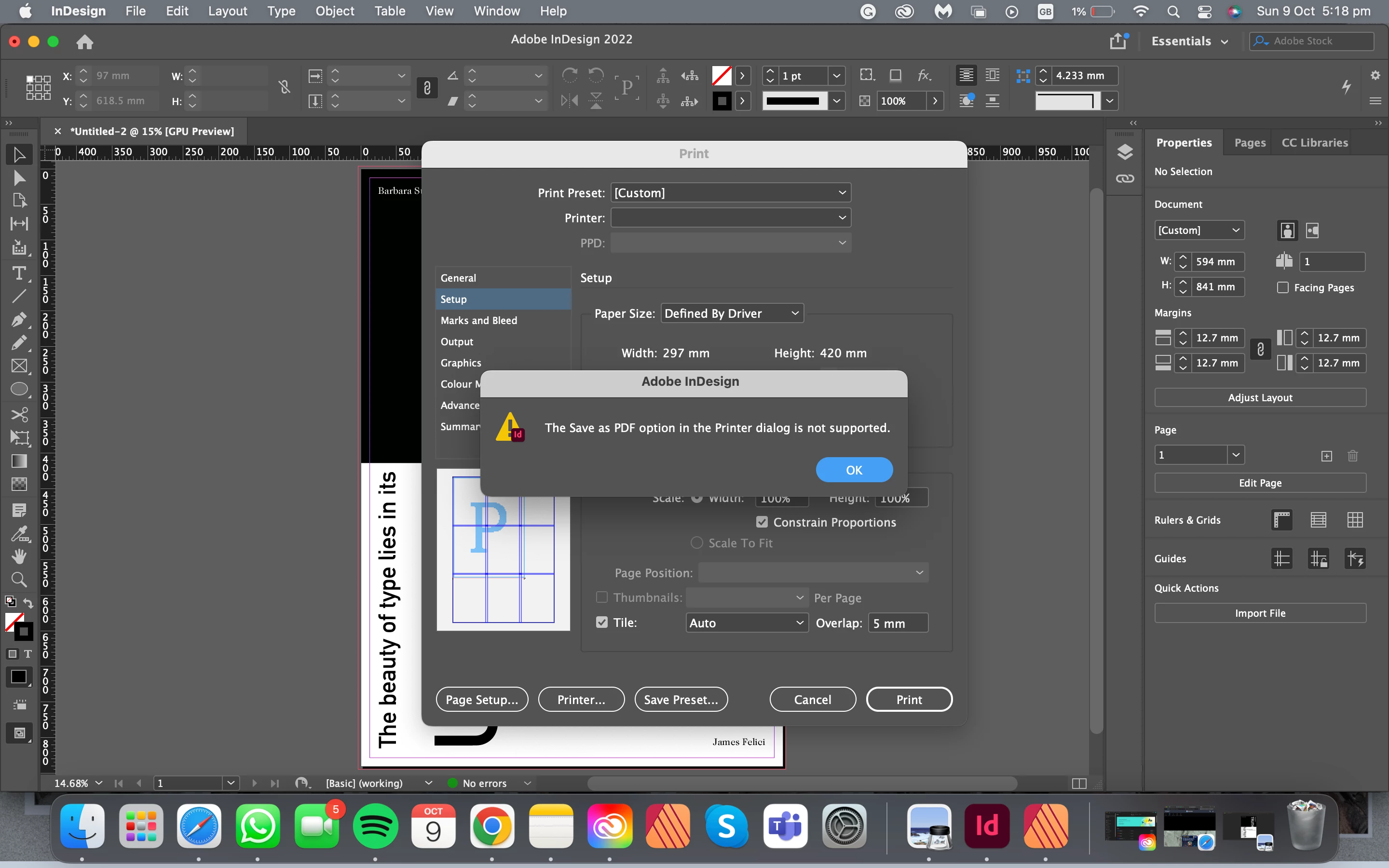

I am doing an A1 print using a tiled format to print (using 4 A3s). I did the tiling settings using the print settings and then tried to save that as pdf which I could do in affinity but I recently made the change to indesign. but when I tried to do that in indesign it says it's not supported. I was wondering how I could fix that or save my tiled version as a pdf so I could print it in my unis printer (it has to be printed as a pdf).

it has to be saved as a pdf to print cuz that's how my uni printers work. I tried to export it as pdf (print) but then it wouldn't save my tiling settings..

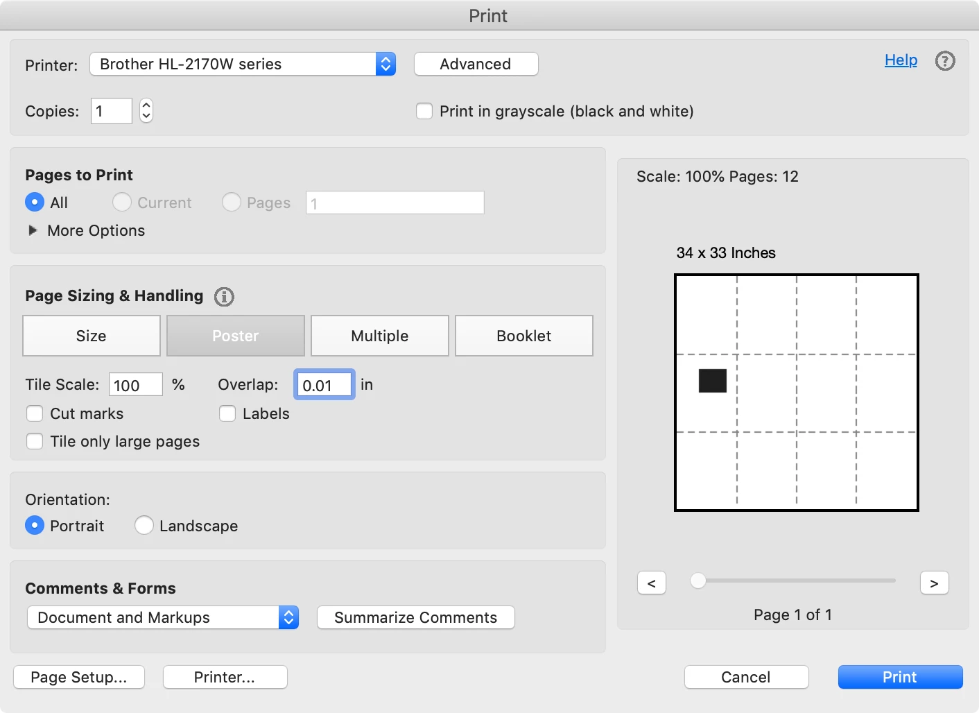

Hi @angelena chang , Acrobat’s Print dialog also lets you tile. Couldn’t you tile when you print the PDF from Acrobat?

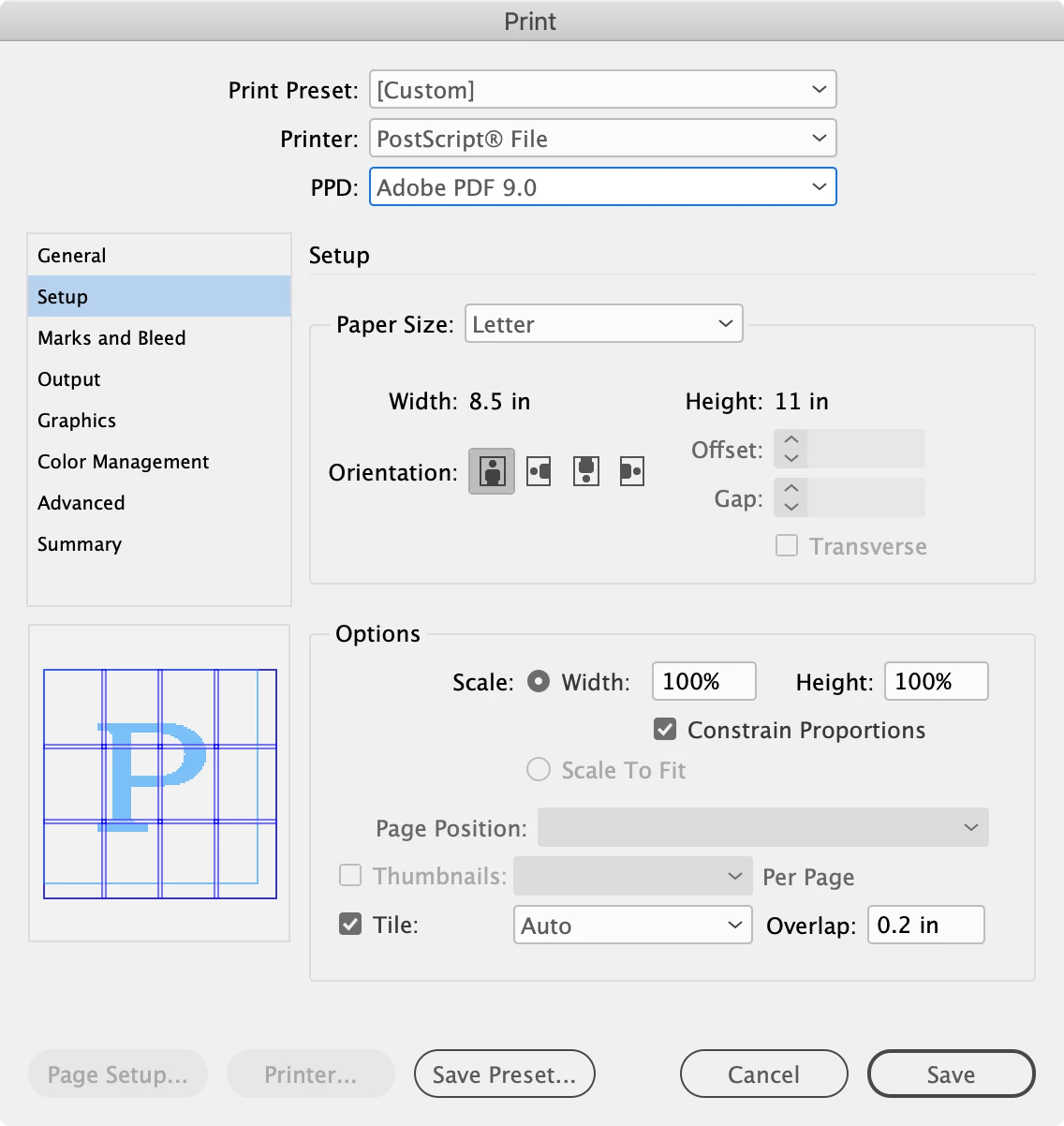

If that’s not an option you’ll need to install the Adobe PDF 9.0 PPD and Distill the .ps file. Download is here, follow the install instructions carefullly
https://helpx.adobe.com/indesign/kb/add-acrobat-ppd.html
