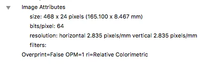

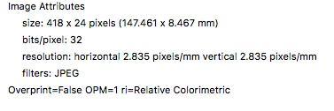

January 24, 2019
I was litreally testing that
I had a 16 bit image and an 8 bit image on the same page
I replaced the first image in photoshop - with the 16 bit image
And left the 8 bit image alone
Results from the object inspector
Replaced the 16 bit image and now it's bits/pixel: 64
Original image bits/pixel:32
Seems to have desired affect.
